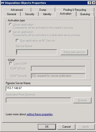

I"m trying to change the Remote server name of an Object in COM+ applications through Visual basic. The code is running without any error, but when i check the remote server address manually in Component services-->com+ applications, selecting the object, went to properties, opened the ACTIVATION TAB, but there the Remote server address is the same old, its not getting updated. I'm posting the code below and the picture of component address which i verified manually. Please find a solution or what changes to be done to code to get the server address updated as like shown in the code.

by: EDDYKTPosted on 2009-09-21 at 04:37:43ID: 25381841
it works for me
1. make sure you have admin permission to perform
2. have you refresh COM+ applications? ie from dcomcnfg, highlight COM+ applications and then refresh
by: jlaxmiPosted on 2009-09-24 at 14:26:16ID: 25418125
Yea i did refresh and tried, but its not changing. But i'm sure the appliacation proxy server is changing, when i debug through the Immediate window, i'm getting the previously registered Address, but when trying to see manualy, its not displaying the REMOTE SERVER NAME
by: jlaxmiPosted on 2009-09-28 at 10:51:56ID: 25441484
EDDYKT,  now its working fine as you said when refreshing the components, its changing, thanks for the solution
