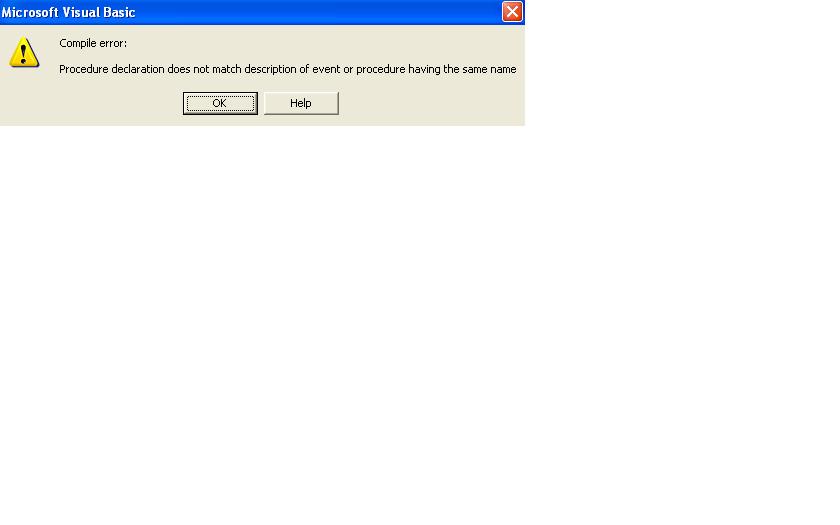

When I try to compile a modified visual basic 6 project I get an error
Asked by: itbabe
see below.
How can I see what is causing the problem.
I have basic vb knowledge.

by: VBClassicGuyPosted on 2009-09-24 at 12:33:59ID: 25416903
Is it possible you declared an API call and made a typo or left out a passed argument? Or possibly aliased it and used the wrong name?
by: GrahamSkanPosted on 2009-09-24 at 12:36:46ID: 25416933
What is the code at the failure point?
It generally means that an Event procedure has been changed,. Either the visible code has been change by the programmer, or the hidden code of the object has been change - e.g. by an update to the .OCX or .DLL.
This will give the error because the button Click event does not have a parameter
Private Sub Command1_Click(i As Integer)
MsgBox "Hello"
End Sub

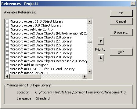

by: GrahamSkanPosted on 2009-09-24 at 14:39:26ID: 25418276
itbabe,
You are very reticent with the details, but there was an importance change in the ADO model which could produce this error. It should now have worked itself out, but we need to know more.
Are you using ADO at all?

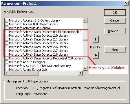

by: pathakhemantPosted on 2009-09-25 at 00:39:28ID: 25420734
Dear
its your ADODB Version Problem Please Check Your ADODB Version
Just Open your Project and Go Project Menu->References
by: pathakhemantPosted on 2009-09-25 at 00:42:38ID: 25420748
Dear
by: itbabePosted on 2009-09-27 at 00:34:49ID: 25433060
Apparently by coping controls I copied them as an array and that caused the problem.
