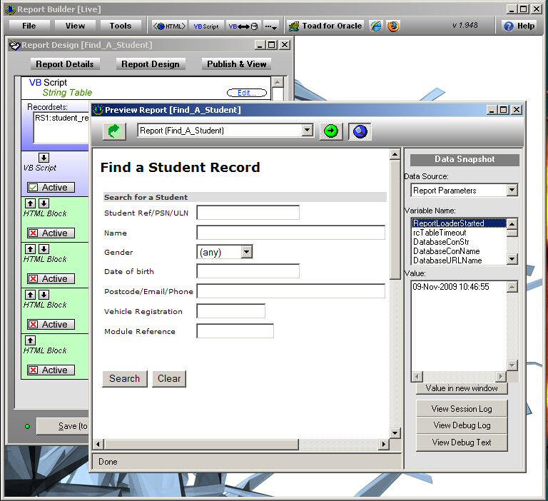

Thanks... thats not quite it.
I have made an IDE for web-pages.  It has been in-use for some years, but the "Preview function" uses a web-browser control. Most of the pages made will use form-posting.
I have had-to override the context menu so "View Source" is not available.  I have written my own, but it means that it is (as detailed above) IEs version of the source, not the real thing.  Would some screen-shots clarify?
by: dentabPosted on 2009-11-05 at 00:10:41ID: 25747518
btw, I am out of office till Monday now - so I may not reply till then
by: dentabPosted on 2009-11-09 at 02:53:42ID: 25774785
The IDE has a "preview" window, which has additional debugging information.
The webbrowser control with it shows the actual page.  I added a view source a while back, but its using the outerHTML or innerHTML method.
also @FER_G:... outerHTML or innerHTML does not work the same with XHTML for some reason.
