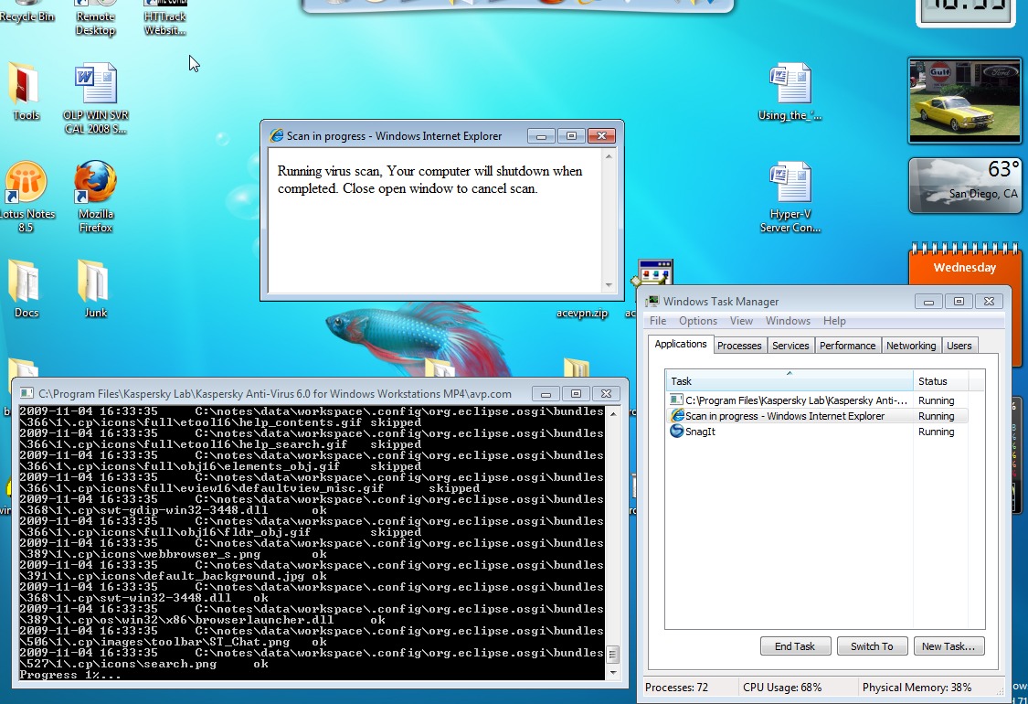

Ya, No joy. Thanks for the work. I really appreciate it. From what I can see Windows 7 has some sort of security built in to not launch the IE windows. It works fine when launching it from the desktop but not on shutdown.
This the real code that i am using. I removed the meg box because users tend to hit shutdown and walk away. SO I just want it to scan and they have the ability to cancel if they like by closing the window.

by: TheNauticanPosted on 2009-11-04 at 16:25:55ID: 25745671
ok, once it "runs" do you see iexplore in the tasklist? Also, what ver of IE is on win7?
by: clynch302Posted on 2009-11-04 at 16:35:09ID: 25745725
Yes it is on the tasklist. I am running IE8
by: TheNauticanPosted on 2009-11-04 at 16:37:20ID: 25745741
wait, I thought it wasn't showing? Is this from your win7 box? My understanding is that you try to run the script...the IE window never appears, but the virus scan runs. then just shuts down.
by: clynch302Posted on 2009-11-04 at 16:41:46ID: 25745777
It runs fine if I launch it from windows. But If I put the script in GPO shutdown and I perform a shutdown all I get is the shutdown screen 'Shutting down...'. Thats it. No IE window with the message. It performs the scan cause I can see the HDD spinning like crazy. The screenshot is me running the script manually.
by: clynch302Posted on 2009-11-04 at 16:48:46ID: 25745818
I thought about creating a custom background image with the message but Windows 7 uses the same background image for shutdown and start up.
by: clynch302Posted on 2009-11-05 at 12:58:41ID: 31649768
I guess it is not possible in Windows 7
