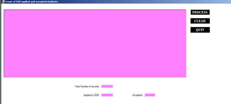

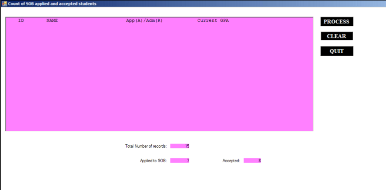

I have attached my assignment via the attached pdf.  I am so close......When I click ''process'' the data appears in the list box as expected.  When I click ''clear'', the program responds correctly.  HOWEVER after clicking ''process'' again (after the ''clear'') only the column name headers appear.
THE PROBLEM:
If ''clear'' is pushed, I expect my results to reappear after clicking ''process'' however they are not.  Please help!

this is the loop in the Process.
>Do While cnt < 15
where do you reset the cnt value to 0 ?

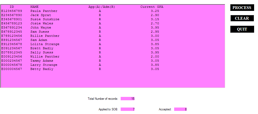

okay, here is our new code.....making progress.....
Clicking Process achieves the expected results.  Clicking Clear also works as expected.
HOWEVER, after clicking Process again, it continues to append the exact data over and over and over.
The GOAL:  After clicking Process we don't want it to continue to append the additional data over and over......how can we prevent this?  (per the assignment it must be a counter)

when clicking the "process", you want to run the same code as when clicking the "clear", to start with.
I would suggest you do like this:
ps: I would have put the cnt = 0 into the clear process...
Private Sub btnProcess_Click(ByVal sender As System.Object, ByVal e As System.EventArgs) Handles btnProcess.Click
  btnClear_Click sender, e
  ... rest of code ....

never mind!!!!!! it works!!!!!
by: sknoll84Posted on 2009-11-05 at 15:16:54ID: 31650784
awesome!
