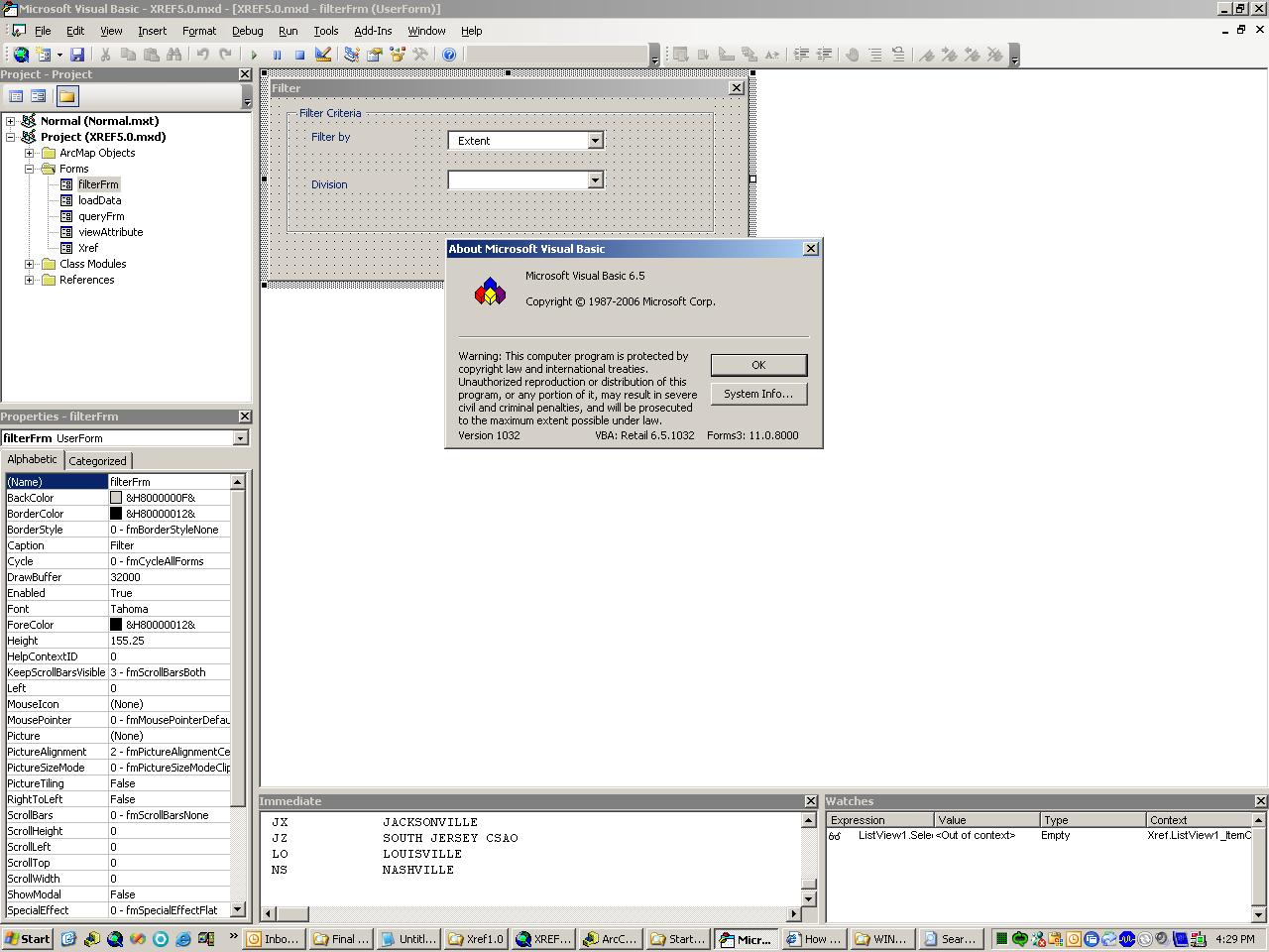

Iam using VBA(ie visual basic 6.5) and i dont see the any Microsoft Calander Control 12.0. Please see the attached image for the version. How can i get the MSCAL.OCX or download and register with the windows
by: VBClassicGuyPosted on 2009-09-09 at 13:40:25ID: 25295335

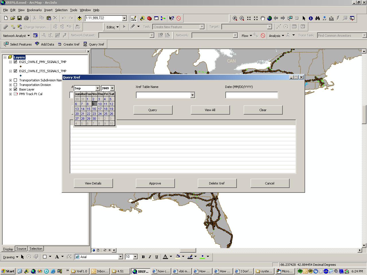

Thanks for that solution it worked, but i have only one porblem the calander is opening on the left,see attached the imgae rather it should open close to the text box. see the image for details

by: VBClassicGuyPosted on 2009-09-10 at 05:45:33ID: 25299580
The line in my answer code that reads:
Calendar1.Move X, Y
is what positions the calendar. If you don't like the position, either place it where you always want it to be and delete that line of code, or play with offsets such as:
Calendar1.Move X + 1200, Y -600
Or if you want it positioned relative to the textbox, play with it like this:
Calendar1.Move Text1.Left, Text1.Top 'puts it right over the text box
or
Calendar1.Move Text1.Left + 600, Text1.Top -600 'play with the numbers until it appears where you want it.
