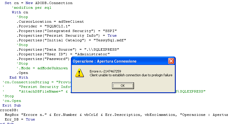

by: Joice64Posted on 2009-08-18 at 00:34:11ID: 25120737
Hi game-master,
I am using a trusted connection (windows authentication) and used as User Id and Password the same in the WITH command value. But I have the same issue.

I suppose there is a wrong value in the code, debugger no show error, the database is not open and receive the error showed in the snapshot.
