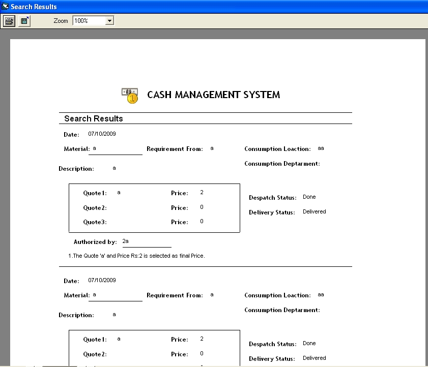

I have an application which uses ado recordsets and MS access as backend and when i generateVB data report, it generates same records from the recordset.
If the search results return 6 records then those 6 records are the same records in the report
If all records in the DB are generated as reports, the report has the same record in the full report !

I'm searching the records with material field like "a" then it should return those 6 records with 'material field' having 'a' in it right?
But wats the case here is , it searches all records and find the matching records and while getting generated in report it becomes faulty ie. it prints the first of those 6 records 6 times.....

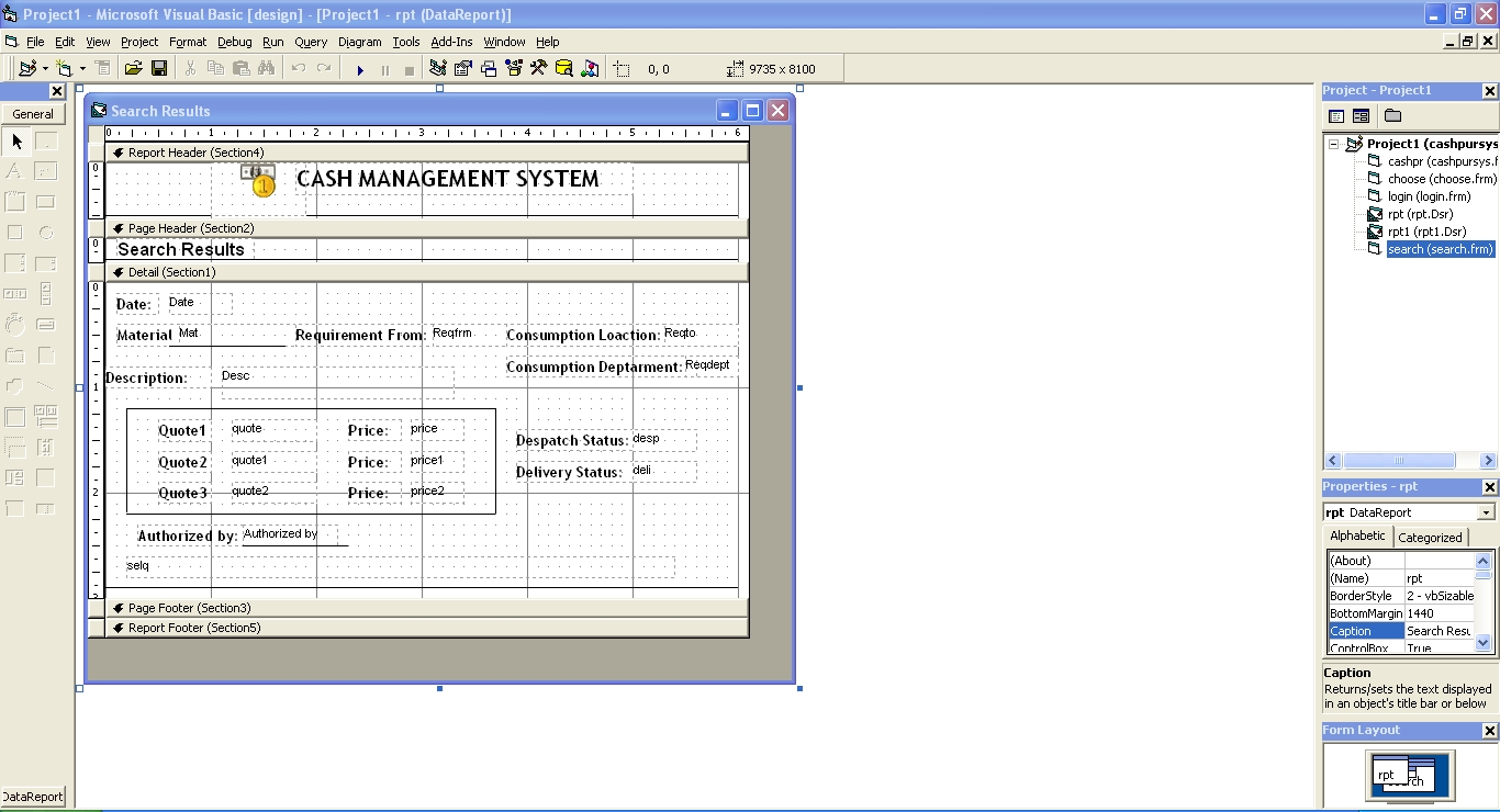

This generally happens when the fields on the report are in the wrong section of the report. Do you have grouping in the report. can u post a screenshot of the report designer?
by: ranjithkuziPosted on 2009-10-27 at 04:41:23ID: 25671192
Sure !
Report design is attached !
All the fields in my rpt are RPTLABELs ! is that a fault ?
by: northfieldsPosted on 2009-10-27 at 04:50:05ID: 25671264
Hi
The fields bound to the data should be textboxes.
by: ranjithkuziPosted on 2009-10-27 at 05:00:15ID: 25671343
If I change them to textbox will it run correctly?
Wait for 10 mins I shall change them to textboxes
