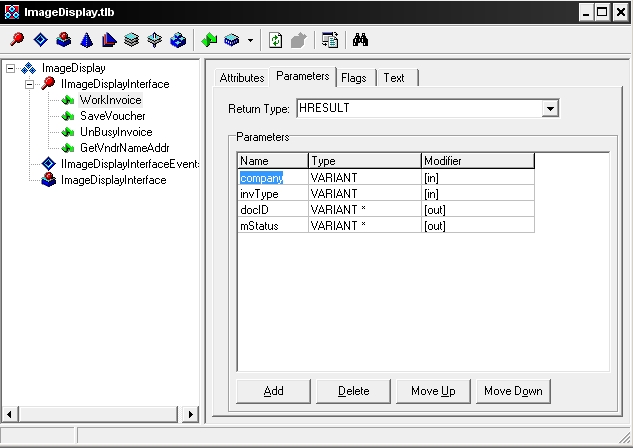

I have a Automation Server which I have added methods to.   It is a visible, out-of-process, apartment threaded.  When I defined the interfaces using the Type Library Editor, I thought I had included HRESULT as an automatic return value.  Maybe it is and I just don't know how to use it (LOL)?
A. Below is a screen shot of a method from the Type Library editor.
B.  In the code section are two programs in order:
1.  ImageDisplay_TLB.pas - automatically created by Type Library editor.
2.  ImageDisplayInterface.pas - where I write the interfaces and handle in/out variables passed from the calling program.
Questions:
1. Have I defined the interface so I can query HRESULT in the calling program?  If I have not, how do I setup HRESULT to use it?
2.  I call the server from vbscript (vbs) as follows:     iResult = mySrvObj.WorkInvoice(vCompany, vInvType, vDocID, vStaus)
mySrvObj is already instantiated.
After I make the method call, how do I interpert HRESULT in vbs?
Thanks much.
    • 102 KB
    Screen shot of Type Library Editor for a method call

by: ziolkoPosted on 2008-08-30 at 11:09:39ID: 22352750
in this case you have "safecall" option which means that if HRESULT is different than S_OK an exception will be raised on clcient side, so to answer your question... you have to use try/except and catch EOleException, like this:
  try
  except
    on E: EOleException  do
      E.ErrorCode
  end;
ErrorCode will have value of HRESULT
ziolko.
by: ziolkoPosted on 2008-08-30 at 11:16:43ID: 22352781
oops it was about vbs... I guess in vbs you handle exceptions in different way I guess you need something like:
On Error ...
and then:
Err.Number
ziolko.

Hi!
You should add a result parameter to IDL method def and mark it as [Out, RetVal], it should be of a pointer type (marked with asterix).
HRESULT _stdcall Method1([in] long ParamIn, [out, retval] HRESULT * pResult );
now you will get the function Method1 declared in you interface and possibility to assign Result in interface implementation to value you want to return to caller. you can use whatever OLE type you want for return value (BSTR e.g. WideString, for example).
You shouldn't change Return Type as this (HRESULT return type) is requirement for Automation interfaces and are handled/used internally.
wbr, mo.
