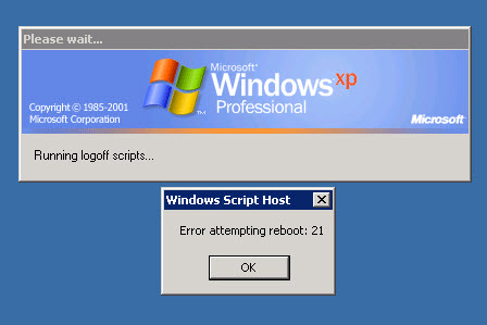

I have the following script that when executed force a Windows computer to reboot.
If I manually run the script the computer reboots fine. If I run the script on when the user logs off
(via GPO).
I get the error message shown in the picture.
Does anybody know how to modifiy this script so I don't get the error message and the forced reboot gets completed?
Or any other script that I can use to force a reboot so far I have tried with these two but neither worked when applied to a log off:
1.)
Set OpSysSet = GetObject("winmgmts:{(Shutdown)}//./root/cimv2").ExecQuery("select * from Win32_OperatingSystem where Primary=true")
for each OpSys in OpSysSet
    OpSys.Reboot()
next
2.)
Dim oShell
Set oShell = CreateObject("WScript.Shell")'restart, wait 5 seconds, force running apps to close
oShell.Run "%comspec% /c shutdown /r /t 5 /f", , TRUE
Dim objWMI, colOpSys, opSys
Set objWMI = GetObject("winmgmts:{impersonationLevel=impersonate,(Debug,Shutdown)}")
For Each opSys In objWMI.InstancesOf("Win32_OperatingSystem")
 intRet = opSys.Win32Shutdown(2+4,0)
 If intRet <> 0 Then
  WScript.Echo "Error attempting reboot: " & intRet
 End If
Next

by: dstewartjrPosted on 2009-10-31 at 19:41:41ID: 25712424
The logoff process is probably killing the restart process making the script fail.
You know what would probably work, is that if you had the logoff script execute a cmd on another computer that reboots the computer that was logged off of(using psexec or psshutdown).

by: llaravaPosted on 2009-10-31 at 20:26:50ID: 25712506
Regarding to the script I posted before.
Looks like intRet = opSys.Win32Shutdown(2+4,0) is not able to perform the reboot because the log off is taking place.
I have also tried with a shutdown -r -t 0 and I don't get any error message but once again the log off takes over the shutdown command.

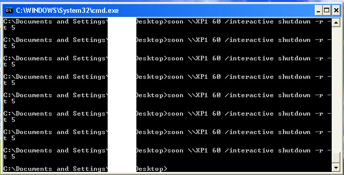

by: dstewartjrPosted on 2009-10-31 at 21:01:17ID: 25712555
Ok this works
http://www.microsoft.com/downloads/details.aspx?familyid=ca8191e6-9eef-4975-b51c-8d670748ca8e&displaylang=en
you can place soon.exe either on a share or in system32 folders
save below as restart.bat and use as your logoff script
soon \\%computername% 60 /interactive shutdown -r -t 5
by: llaravaPosted on 2009-10-31 at 21:26:53ID: 25712611
I've manually tried the command and seemed to work fine. The soon.exe scheduled an AT task and peformed a reboot.
I have tried to create the .bat file and pasted the line of code (before I copied the soon.exe over system32) when I run the bat file it doesn't seemed to work I get into a loop where the line of code repeats over and over again (I can see that on the MS shell window).
by: llaravaPosted on 2009-10-31 at 21:30:27ID: 25712614
This is what I am talkign about it.
by: dstewartjrPosted on 2009-10-31 at 21:34:41ID: 25712622
i tested it with soon.exe in the system32 folder and by putting the .bat file in the logoff script section of GPO
by: llaravaPosted on 2009-10-31 at 21:39:44ID: 25712629
How are you creating the batch file.
I have created a .bat file and then pasted the line of code. When I double click on the .bat file I get the cmd window I have attached.
by: llaravaPosted on 2009-10-31 at 21:41:32ID: 25712632
Forget it I added a cd\ before the line of code...and worked fine this time. It's extrange though becasue I have place the soon.exe on system32.

by: llaravaPosted on 2009-10-31 at 21:57:51ID: 25712668
I have removed the "cd\"
and modify the line of code adding .exe (soon.exe \\%computername% 60 /interactive shutdown -r -t 5)
...now works fine with GPO.
So I was missing the .exe and the "\cd" was messing the whole thing up.
