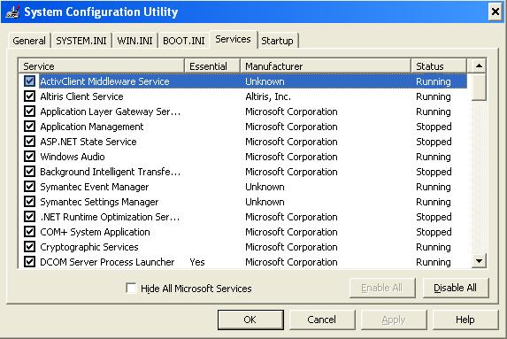

I need to disable the following service from the "Services" tab.
     "ActivClient Middleware Service"

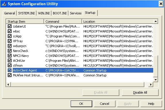

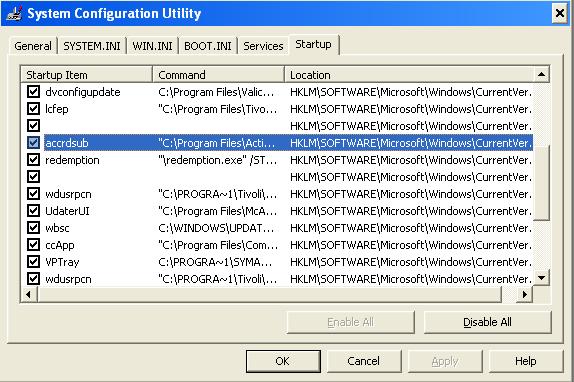

I need to stop these services from starting in the "Startup" tab.
     "ActivClient Agent"
     "accrdsub"

I've attached pics of the 3 items I need to target.

Set colServiceList = objWMIService.ExecQuery ("Select * from Win32_Service where DisplayName = 'ActivClient Middleware Service'")
For Each objService in colServiceList
	If objService.State = "Running" Then
    	objService.StopService()
        Wscript.Sleep 5000
    End If
    objService.ChangeStartMode("Disabled")
Next
strKeyPath = "SOFTWARE\Microsoft\Windows\CurrentVersion\run"
strValue = "accrdsub"
objReg.DeleteValue HKEY_LOCAL_MACHINE,strKeyPath,strDWORDValue
'Or whatever shotcut you have in there
objFSO.DeleteFile "C:\Documents and Settings\All Users\Start Menu\Programs\Startup\Calculator.lnk"
