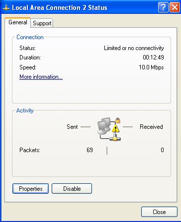

Also, you can see by the picture below that my new 2nd network connection isn't looking good.

Since I enabled the loopback hardware, my computer now has two network cards per say. This new, second network adapter has received a new IP address through DHCP but apparently it is only partially configured. That is, it does not have a default gateway. Also, my primary adapter starts with '192'... but the loop back virtual network card shows a number starting with '169'...
I see this using the IPCONFIG command and the adapter is identified by the words 'Connection 2'. I would think the IPCONFIG command would have shown an address of 127.0.0.1 - what's up with that? This is supposed to be the loopback network card and it shows something other than 127.0.0.1

Yes, I get a reply but something still isn't right if I consider the 2nd adapter's icon in the tray (see the picture)
