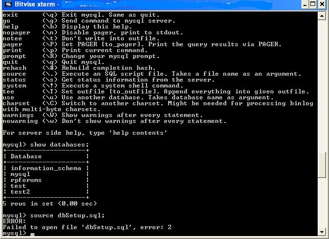

i created another file and moved the files to the server and tried your command.  See pic.  i get failed to open file.
this is the only thing in the file:  create database lftest;
by: justmelatPosted on 2009-09-15 at 12:04:40ID: 25338113
got it.  even though it's sitting in the directory, i decided to add the entire directory location and it worked.
