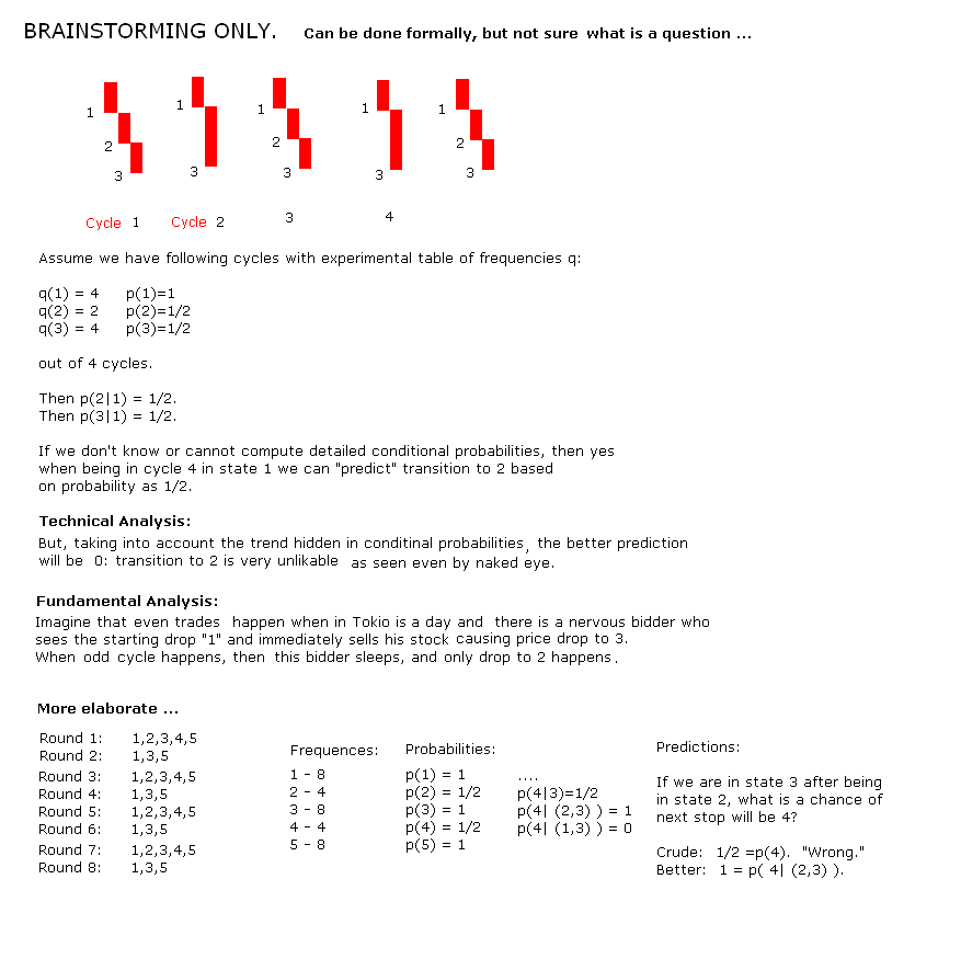

3) It is possible, that we are asking about transitional probabilities or about path probabilities:
p( 5 | ( 1,2 ) )
or
p( 1,2,5 ).
The answers are similar to 1) or 2)
1) Correction:
"p(1,2) and answer does not exist. Build additional tables while making first 5... tries,"
must read:
"p(2|1) and answer does not exist. ...."
2) It will be nice to know more about your TM which can lead to unexpected solutions.
For example, if one sells cookies from the bag, then probability of next stop will decrease if the bag is emptied at previous stops. However, if TM is different, like if one sells pens, then capacity of the bag is greater, and probability of next stops increases.
Or, if there are two bus routes skipping different stops, then hidden dependence should be collected in tables of conditional probabilities.

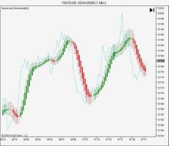

I am building a rather complex indicator for forex trading markets. Basically, I have an indicator called "heikenashi", being japanese for "average price bars". This is a series of bars on a trading chart that are noted by color. The heikenashi bars have two different directions -- up or down. The attached picture is the color coded heikenashi bars. Don't worry, I know this isn't a trading forum, the math problem factors into it :)
If we are trading that chart (in the attached picture), the current number we would be on is "10"...which means we are on the 10th red bar in this given series. Each time you start a new series on a new color, your "count" starts over.
What I am looking for, is since we are on number "10" right now in this series, giving historical data, what is the probability we are going to go to the "11"th bar in this series?
I can obviously grab any sort of data need be from the chart. What information would be needed, if the current amount of information given isn't enough?
