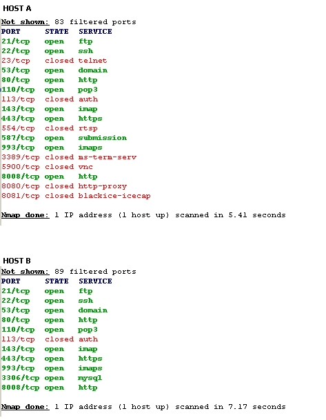

I am having a problem connecting via odbc to a MySQL database on a remote host.  The host said the problem is not on their end.  I don't think the problem was on my end becuase I can connect to other MySQL databases using odbc on other hosts.
I downloaded a copy of NMap and rant it on both hosts.  The problem host (HOST A) and the host where I CAN connect (HOST B).  Port results are below.
Questions:  I know MySQL listens on port 3306.  As you can see, on Host B, 3306 is shown as OPEN where it is working fine.  However 3306 does not even show on the HOST A results.  DOes that mean it is definitely NOT open?
What makes a port display here or not display on this scan list.  Both hosts have many ports (83 & 89) that are "Not Shown".  What keeps them from being shown and if they are not shown, does that mean they are closed?
I am confused by that because on HOST A it does include some "closed" ports on their list.
Just trying to understand this... I already sent them an email that said I didn't think they had 3306 open... so I hope I didn't "jump the gun..."

closed means it checked that port but no application was listening on it.  The fact that 3306 does not show up for the host should mean either 1.) mysql is not running and so not listening on port 3306, or 2.) access to port 3306 has been blocked although generally that will show as "filtered" if a firewall is actively blocking it although it might just not show up depending on how the firewall works.
So by all means send the nmap results along saying that port 3306 is not open for requests and suggest they check the status of mysql and any firewall they have on that host.  Also ask if maybe they are using a non standard port to run mysql on.

If 'nmap' does not list a part, it does NOT mean that there is not a service on that port.  It is possible to have a service running on a port and still hide it from nmap (easily done w/ a firewall/iptables).
In your situation, though, you should be able to connect to port 3306 on Host A.
From host B, do this:
  telnet host_a.whatever.com 3306
Do you get anything?  If you see "Escape character is '^]'" you connected - otherwise, something is blocking you.

If it was working and then stopped and you couldn't talk to mysql anymore combined with nmap showing 3306 not open on their end I'd definitely put that on them to fix.  Just send them everything you know including the nmap stuff.

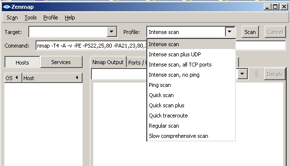

I didn't.  I ran it from my own machine here at my desk and put the server address in ('target'.)
I have like a windows version of it I downloaded when I saw a reference to NMap from another post.
