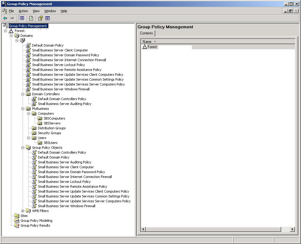

by: edli83Posted on 2009-09-02 at 01:13:31ID: 25238874
I dont understand what to do in the GPMC as I only see is the different SBS policys, can you expand please?
So from what you said I need to create a new group and then add this group to "allow local logon", that right?
by: CoccoBillPosted on 2009-09-02 at 01:16:30ID: 25238893
That's right. In RSOP when you look at the log on locally right, it will say next to it which is the effective policy where the setting comes from. You need to edit that policy in GPMC and add the new group there.
by: CoccoBillPosted on 2009-09-02 at 01:19:55ID: 25238912
I don't have an SBS here I could check from, but in Vista the setting is "Allow log on locally" under Computer configuration -> Windows Settings -> Security settings -> Local policies -> User rights assignment. There's 2 columns, Computer setting which is the effective one and Source GPO which is the group policy object you need to edit. The place should be the same or similar in SBS.
by: edli83Posted on 2009-09-02 at 01:22:28ID: 25238929
i cant really see anything similar... am i in the right place?
by: CoccoBillPosted on 2009-09-02 at 01:31:34ID: 25238967
Yes you're in the right place. Did the RSOP tool specify which GPO the setting was coming from? Right click that policy in GPMC (under Group Policy Objects) and select Edit.
If RSOP just states Not defined with no Source GPO, there's no domain policy affecting the setting and you can edit the setting in the local security policy (run gpedit.msc).
