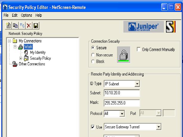

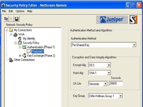

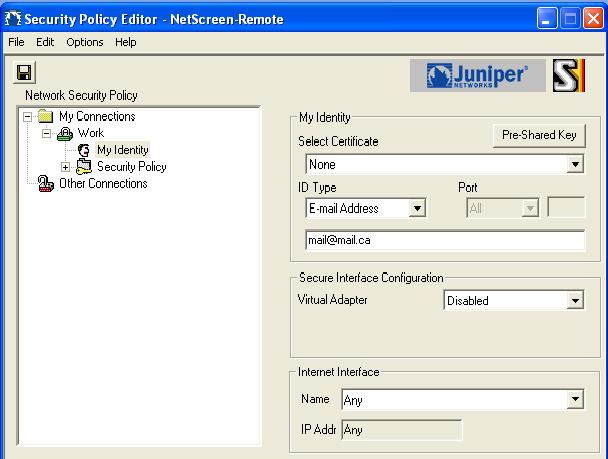

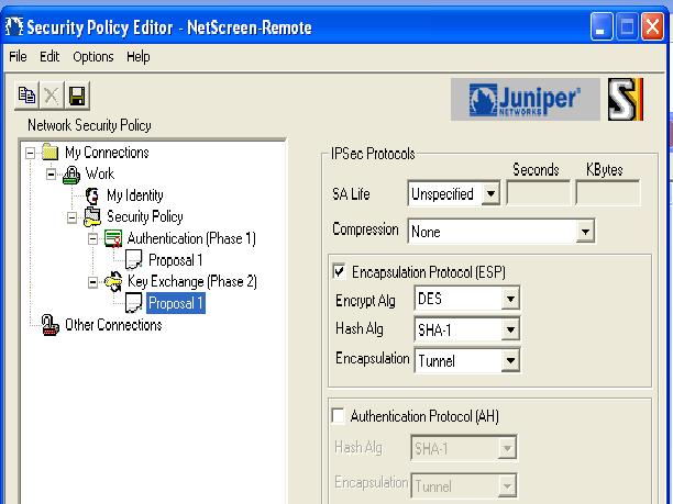

I caanot seem to get my netscreen remote to make a connection.  It's like trying to connect to the CIA.  I followed instructions from articles, step-by-step instructions ... you name it I read it.  I do not understand this firewall and I need help.  The following is the message from the log viewer of Netscreen Remote:  (Following this is the log from the hardware)

I folowed the step-by-step instructions to the letter.

The screenshots are fine for client configuration; I do not see any problem. Client logs are same as first post and do not give any information why the negotiations failed.

by: primesolutionsPosted on 2008-06-05 at 13:16:20ID: 31459648
I found the problem in the phase 2 negotiations ... simple ... it was set for MAIN MODE.  Once set to aggressive ... it connected
