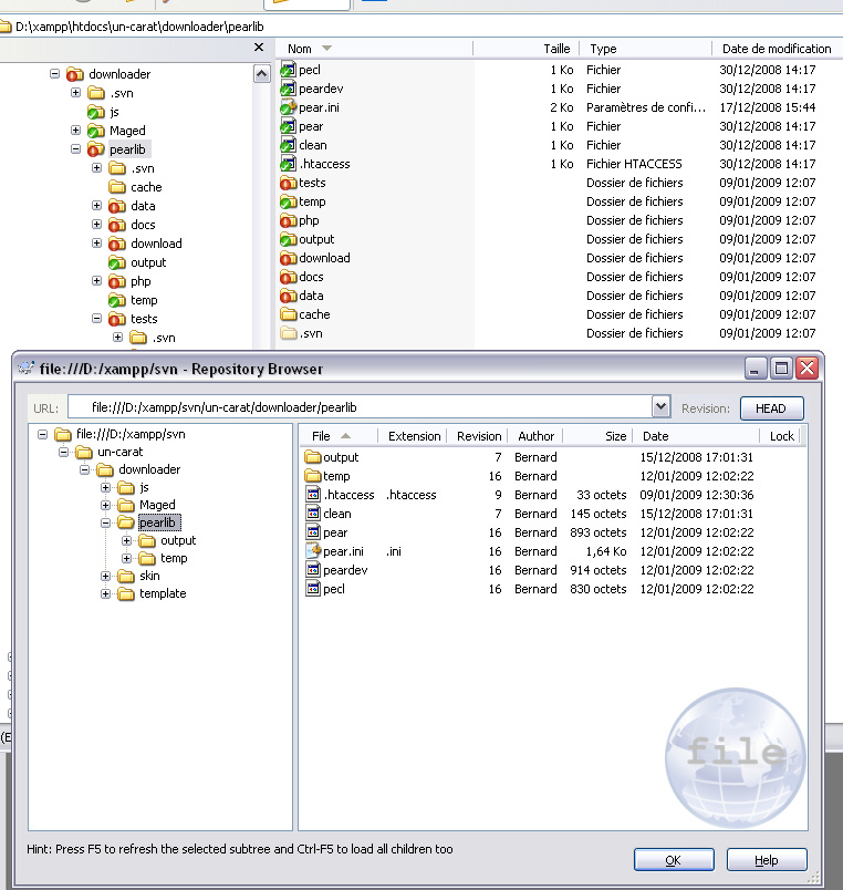

1 - Update did the trick. It was safe because the only changes that remained where on the directory itself, not on the file it contains. THX A LOT
2 - The cleanup thing did NOT work though. No easy way to make a text capture of the error message, so I attach a screen capture. My version is in French.
"Dans le répertoire" means "in the directory"
"Erreur en exécutant la command" means "Error while processing the command"
"La copie de travail" -> the working copy
"est verrouillée" -> is locked
When I try to unlock the \data which is said to be locked, I get the error message "There's nothing to unlock. No file has a lock on this working copy"
B-((

by: sunnycoderPosted on 2009-01-14 at 04:17:47ID: 23371852
right click on the directory, from the context menu, select open repo browser. There would be a column called lock. See if any directory in the path is locked.
by: sunnycoderPosted on 2009-01-14 at 04:18:53ID: 23371858
Also, did you manually delete some files/directories? Or do you have a script or a cleanup process that deletes files/directories from the tree?
by: fiboPosted on 2009-01-14 at 04:32:34ID: 23371929
No directory is locked.
However, the display evidences that SVN "ignores" some directories.
I believe most of this dirs were there earlier.
Then I asked that the directory "cache" should not be synced.
This apparently worked... but I probably did something else so thee are more directories ignored... And when I try to "add" the directories, I'm told there is nothing to add since all the files are all present in the repository...
