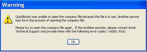

Hi Gang,
This problem for one of my clients just started occuring about 2 weeks ago.   Prior to this, they were working just fine.
I've got Quickbooks 2007 Pro installed on the file server.   The company file is located on one of the file shares.   I've got Quickbooks 2007 Pro installed on each of the workstations.
When I copy the file onto the local hard drive, it works fine.   When I try to copy it back to the file share, I get an error message saying:
"Quickbooks was unable to open the company file because the file is in use.  Another person may be in the process of opening the company file."
It has an error code (-6000,-816).
I've gone through Intuit's knowledgebase article: KB ID# 8773d9d4
But still no joy.
Any ideas?

by: thinkpads_userPosted on 2009-10-13 at 18:47:52ID: 25566546
From that article, are you saying you copied the ledger (.QBW file) to a local computer and could not open it?  If so, that means the file is probably damaged. Please let us know about this point.
... Thinkpads_User
by: OpihiNetPosted on 2009-10-13 at 19:24:28ID: 25566774
No.
When the QBW is on the server, I can open it on the server, but not on the workstation.
When I copy the QBW to the workstation, I can open it on the workstation.
When I copy the QBW back onto the server, the workstation cannot open it anymore.
by: thinkpads_userPosted on 2009-10-13 at 19:40:43ID: 25566825
The answer is somewhat strange because if you can open the ledger somewhere, you should be able to open it anywhere. Try this:
1. Make very, very, very sure you have a copy (or two) of the file on the server that you say you can open.
2. Copy it again to the workstation.
3. Run a Verify on it. QB -> File -> Utilities -> Verify.
4. If errors, run a Rebuild. QB -> File -> Uilities -> Rebuild.
5. Make sure you have installed the QB Server Manager on the Server. The Server Manager is is on your QB CD (assuming you are not using Multicurrency).
6. Copy the ledger back to the same physical drive on the server as the Server Manager is installed (usually drive C:)
7. Run the Server Manager and make sure you scan for the ledger where you copied it to.
8. Open QuickBooks on one computer.
9. Make sure QB is not Hosting Multiuser Access. Stop it if it is.
10. Make sure the folder where the Ledger is has been properly mapped to the one computer and make sure you can see the folder and the ledger with Windows Explorer.
11. Now try to open it with QB. Do NOT just open it from the recent file list. Use the button to open or restore a file and navigate to the ledger file on the server.
Where I said make a copy above, make a copy of the ledger. Do not use QB Backup routine right now.

by: OpihiNetPosted on 2009-10-14 at 18:07:35ID: 25576538
thinkpad,
I've run through your complete routine, step by step.   It still doesn't work.   When I copy the file back to the server, and try opening it up on the workstation, it gives me the exact same error.

by: OpihiNetPosted on 2009-10-14 at 19:39:25ID: 25576844
I cannot copy just the QBW file to the server.   As soon as I copy -only- the QBW file, an ND file automatically appears with it.  I don't even need to launch Quickbooks to recreate it.  It just appears.   This happens copying from server to workstation too.
by: thinkpads_userPosted on 2009-10-14 at 19:59:59ID: 25576902
True. I just want a clean .ND file here. Delete the .ND file on the workstation first, then copy it over to the server into the test folder. Another .ND file will probably appear, but I want it to be clean of other references. I am becoming concerned that your ledger is corrupted.

by: OpihiNetPosted on 2009-10-15 at 16:55:59ID: 25585958
I tried both single and multi-user.
by: OpihiNetPosted on 2009-10-15 at 17:00:01ID: 25585975
Okay.... now I've got something interesting stuff to add.
1)  2 of the workstations were hosting multi-user access.   I had to go to the workstations and shut down multi user access.
2)  On the server was both Quickbooks 2004 AND Quickbooks 2007.  I'm not sure how that happened.  But I uninstalled both of them, and re-installed just the QB 2007 Database Manager.
Now I happened to have a copy of the QBW file on a backup tape.   I didn't want to have to use this, because it is a week old, and we would lose a weeks worth of work, but it sounds like it would be worth it.  So I:
1)  Restored just the QBW from last week's backup tape  (so there were no .ND or .TLG files)
2)  Opened it up with on a workstation connected to the file share in Single User Mode, and it opened!!!
3)  I exited Quickbooks.
4)  Tried to open it up again from the same workstation.  Now it won't open again, giving me the same error.
Does that make any sense??
by: OpihiNetPosted on 2009-10-15 at 17:03:53ID: 25585998
Wait....just for the heck of it, I tried it again, and I was able to open it 3 times in a row with no errors.
I then switched to multi-user mode and again I was able to open it 2 times in a row.
I'm not sure what just happened.

by: OpihiNetPosted on 2009-10-15 at 17:29:19ID: 25586116
I did do the uninstall and reinstall of the QB Database Manager just like you said.
I opened the file up in quickbooks, and did a verify and rebuild.   It is saying that I have some duplicates though.
After I finished the verify/rebuild, now I cannot open the file again, either in Single User or Multi User.
by: OpihiNetPosted on 2009-10-15 at 17:34:25ID: 25586135
Well, now I'm stuck.    I did a fresh restore from the backup tape, and now I can't open the QBW file again.

Hang on.....
It looks like it's working now!    I had to completely UNINSTALL SEP MR5 from the Server.   Then I reloaded the QBW file to the server and tried again, and yep.  It works.  Opened it 6 times consecutively with no errors.
This sucks.   Is there any solution from Symantec or Intuit yet?
by: hardatitPosted on 2009-10-30 at 09:20:50ID: 25704464
What we eneded up doing is disabling  file system auto protect in the policies area on the manager and applying this policy on a group that contains all are SQL servers. At this point the only other option is if you have the MR4 install you could revert back to it. A pain either way but what can you do?
by: OpihiNetPosted on 2009-10-30 at 13:30:43ID: 31640864
Thanks for all your help guys.    I never would've correlated the problem to be with Symantec Endpoint Protection.
by: jdraggiPosted on 2009-11-30 at 13:11:30ID: 25937442
Thanks hardatit !  This solved our problem also.  QuickBooks 2008, multiuser access, SBS 2003, SEP 12
by: infernizerPosted on 2009-12-01 at 08:12:13ID: 25943944
Just because it wasn't mentioned earlier, I was experiencing this issue recently when moving some company files around. My solution was to verify that the permissions for the company file were set for the workstation user (all users in my case) to be given read and modify rights (didn't need full control). We use Symantic Anti-Something or other and no problems. As a disclaimer, i will state that I was in QBs 2005 at the time.
by: jdraggiPosted on 2009-12-01 at 09:45:35ID: 25944837
infernizer -- they now have a Network Diagnostics Tool to help with those kinds of problems.  A lot of people have file permission issues or other problems that this tool can pinpoint.  Unfortunately this problem is with Symantec's Server Endpoint Protection software.
The link for this Network Diagnostics Tool is:
http://support.quickbooks.intuit.com/support/networking/nettool.aspx
by: MikeP_NJPosted on 2010-01-11 at 10:08:41ID: 26285578
I have somewhat of a similar issue. But the difference in my environment is...
I have only one user that this happens to if the QB file isn't opened. As soon as another user opens the company file he can get in. The entire disk on the server where the QB files and QB Manager are stored is excluded from within the Endpoint settings on both the server and the workstations. SEPM Version 11.0.5002.333. Any pointer are definitely appreciated!
Mike
by: alanhardistyPosted on 2010-04-16 at 08:42:55ID: 30930799
Have a read of the following for details of what to exclude in the Symantec Settings to get this working:
http://service1.symantec.com/support/ent-security.nsf/854fa02b4f5013678825731a007d06af/6cc9274310e110968825763b0067ee3f?OpenDocument
by: alanhardistyPosted on 2010-04-16 at 09:04:45ID: 30932258
The only change that made a difference for a customer of mine was adding the Firewall Exception.
Basically, create a blank rule and add TCP port 10180 for QB 2008 or TCP port 10172 for QB 2007.
Alan
by: tadduciPosted on 2010-05-18 at 07:07:39ID: 32790358
Upgrade to version 2010. Everything is fixed in that verison.
