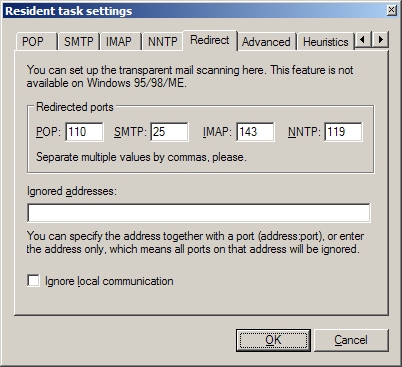

Avast does not scan incoming or outgoing messages where an OE account (eg. googlemail or Yahoo Plus) has to be configured to use SSL Ports:
smtp: Port 465
pop3: Port 995
If I open the "On Access Protection Control" dialog and configure the "Internet Mail" provider, there is a tab named "Redirect" as shown in the attached screenshot.
The description, and also some suggestions in the Avast discussion groups, implies that you can add a comma and then the additional Port in each of the POP and SMTP fields.  I have tried endless permutations of this, but with anything other than the standard ports 25 and 110 in those fields Outlook Express hangs on the "Securing..." part of the check for new messages and eventually errors out as follows:
Your server has unexpectedly terminated the connection. Possible causes for this include server problems, network problems, or a long period of inactivity. Account: 'Google Mail', Server: 'pop.googlemail.com', Protocol: POP3, Port: 995, Secure(SSL): Yes, Error Number: 0x800CCC0F
Extending the Time Out to maximum doesn't help, so OE is clearly just hanging while trying to log in using the SSL Ports.
Does anyone know how to configure Avast Home to use SSL ports without hanging Outlook Express indefinitely on the "Securing..." stage?

Sorry, from Avast help file titled - "Manual Setting of Mail Protection"
The Mail scanner does not support SSL (TLS) connections

"Now, if someone makes a change to the redirect ports in the InternetMail provider of avast to force avast to scan port 995 connections thenit will cause the connection to fail.  So please check in the"Redirect" tab of the Internet Mail provider that the POP box does notcontain port 995."

Thanks for the suggestions, but I have had no success using every possible permutation of the settings suggested in the Avast forums.  The suggestions reqired:
- Installation of Stunnel
- Starting it as a service
- Configuring its *.conf file
- Modifying Avast's *.ini file
- Modifying the Outlook Express account settings
Essentially the settings tell Outlook Express to use standard ports rather than the SSL ones, and you configure the account's pop and smtp fields to use the LocalHost (127.0.0.1).  STunnel collects the email from the secure ports, but Avast scans the email at the local unsecured level.  I recall that a number of AntiVirus applications used to automatically configure Outlook Express accounts in much the same way when you configured the AV product to scan pop3 and smtp email.  I had already tried various settings like this before I read about Stunnel.

in a number of different ways as suggested, plus a number of my own settings, and have also tried adding the alternative Port numbers in Avasts's own "Internet Mail Scanner" settings under the "Redirect (Ports)" tab.

Sometimes the answer is "no, you can't", and this is the correct answer that I didn't really want to have confirmed in the end.
