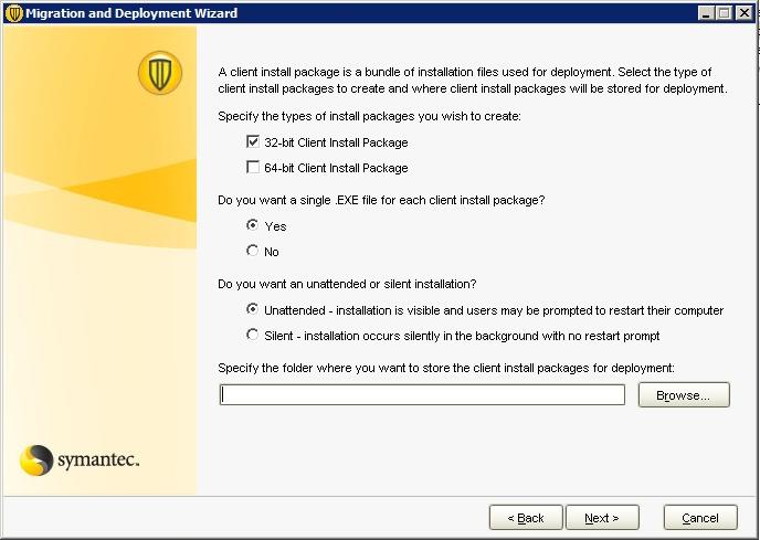

If you built the client packages with the option to install silently then they should not display - if you chose unattended then the install is visible to the user.
by: alanhardistyPosted on 2009-08-11 at 10:58:09ID: 25071600
SEP Choices when creating deployment packages.
