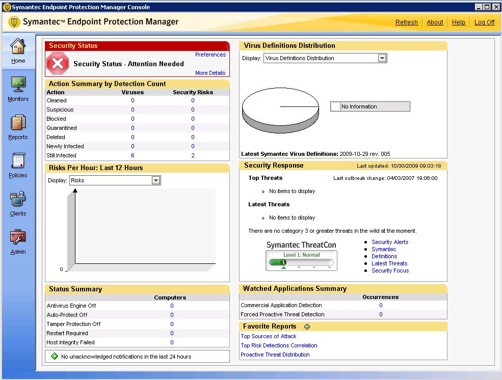

I'm running a managed installation of Symantec Endpoint Protection 11 on an SBS 2003 server.  Everything was working fine.  I was able to manage clients from the console.  It just stopped working.  I logged in and saw what's in the screenshot titled "home".  The home page showed no client machines.  I then went to the "clients" tab and saw that all the clients did not show to be managed.  I went around to several client machines and they did't show to be managed (I mean they didn't have the gold shield with the green dot on it).  I've run the server management configuration wizard several times but still have the same problem.  Thanks in advance for the help.
