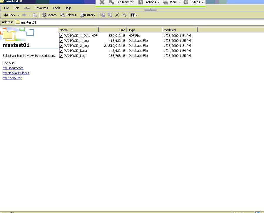

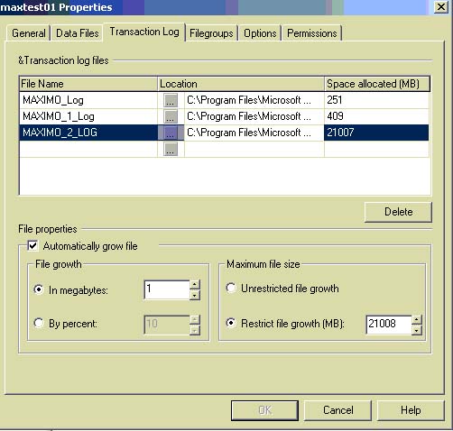

In our SQL Server database the Transaction log file was configured by mistake with unrestricted file growth, so now the file size is 22 GB. I reconfigured with restrict file growth (please see attached). Please can you let me know how to reduce the log file?
Due to log file is there any issue in database?
Please find attached snapshoot for the configuration and file size
Thanks in advance.
pv

    File size location
    File size location

    Transaction log setup

I think the size of log file grew immediately when you setted restricted file growth.
Can`t you set restricted file growth size  to smaller amount?

by: pvcdmPosted on 2009-01-26 at 22:44:27ID: 23474145
nkhelashvili:
I tried to put smaller size lke 400 instad of 21000, but after that it remain same to 21000.

by: pvcdmPosted on 2009-02-08 at 05:29:55ID: 23583523
I did backup and tried to shrink, but no use. still same size
