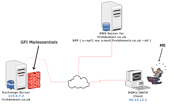

by: GuildOfDruidsPosted on 2008-12-22 at 09:02:53ID: 23227699
A picture is worth a thousand words ;-)
http://i41.tinypic.com/fu04zp.gif
    • 24 KB
    Exchange Server GFI network
by: Chris-DentPosted on 2008-12-22 at 09:12:00ID: 23227758
In this case GFI is busily testing your POP3/SMTP client for SPF validity whenever you try and send. Damn silly thing to do because it really doesn't help much.
We need it to get around the GFI thing because that's where we're dying. But that runs on the same server?
Does the Default Virtual SMTP Server in Exchange still run on there?

Yes GFI is installed on same Server
by: Chris-DentPosted on 2008-12-22 at 09:36:57ID: 23227956
I'm wondering if you can make another Virtual SMTP Server in Exchange and use that. I see that GFI integrates quite heavily with the current server so it's probably a lost cause trying to get through that one unless it has an explicit option for remote users.
What to try the second SMTP server?
Chris
by: Chris-DentPosted on 2008-12-22 at 09:39:58ID: 23227985
What should have been "want". Makes more sense that way..
Chris
by: GuildOfDruidsPosted on 2008-12-23 at 01:59:06ID: 23232376
at the moment GFI is binded with the default Virtual smtp server, If I make another one do I have to bind GFI with the new one?
Also will it bring any down time to the emails?
by: Chris-DentPosted on 2008-12-23 at 02:25:49ID: 23232469
It would be nice if you didn't bind the new one to GFI if it's optional :)
We either need to make the new SMTP server using a new IP address (it will need a new Public IP as well), or a different (non-standard) port. I suspect non-standard port is easier for you?
Chris
by: Chris-DentPosted on 2008-12-23 at 02:26:19ID: 23232475
Oh and it shouldn't incur any downtime if we do it right :)
