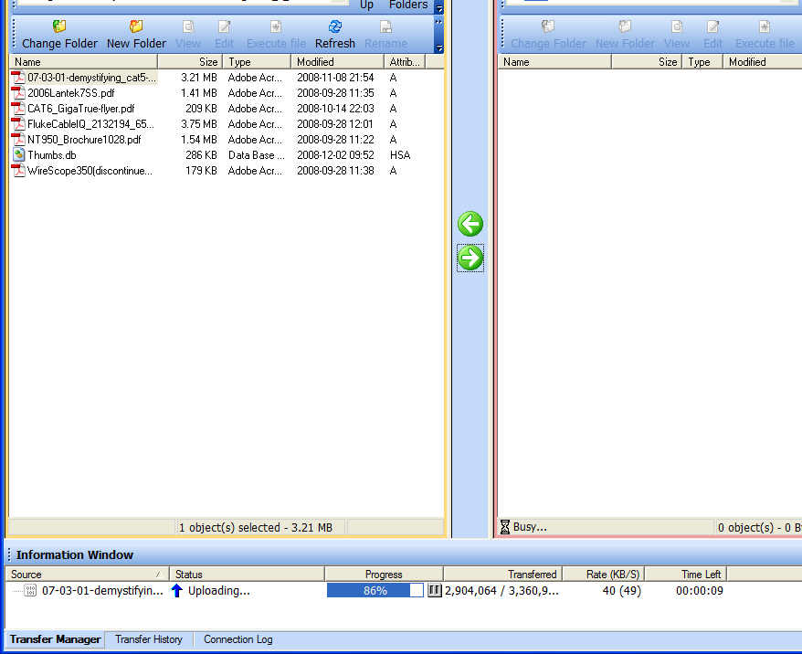

by: Darr247Posted on 2009-02-02 at 17:42:02ID: 23533402
Hmmm... cannot confirm.
Downloaded and installed WS_FTP Home, connected to my web account and uploaded a 3+MB file first try.
To what sites are you trying to connect?
