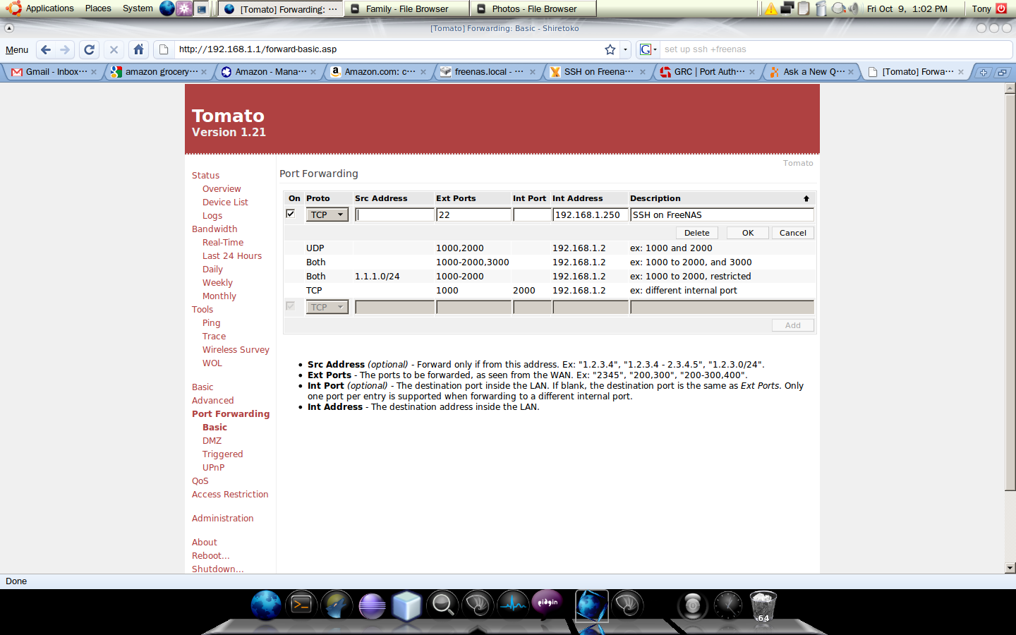

So I'm trying to set up SSH on my freeNAS server, but I seem to be doing something wrong.
I have set up an account with dyndns.org and enabled "Dynamic DNS" on freeNAS
I also have enabled SSH on freeNAS using port 22.
I also have set up port forwarding on my router to route port 22 to address: 168.192.1.250 which is the address for the machine hosting freeNAS

by: giltjrPosted on 2009-10-09 at 11:58:38ID: 25537800
Can you ssh to the FreeNAS box from your local network?
by: arnoldPosted on 2009-10-09 at 12:47:10ID: 25538222
Along the line of giltjr, did you set up a port forwarding on the router to let port 22 to pass through to the FreeNas's IP?
Does the FreeNAS have iptables enabled, and was port 22 opened for all or is it limited to the LAN.
iptables -L
Check the Firewall/security settings.  note only non-root user will be permitted through the ssh based on your selection.
Do you have another local user other than root?

by: arnoldPosted on 2009-10-10 at 11:55:23ID: 25543349
The users you are using seem to be predefined service users.  look at the shell type for each user you used or run the following
awk -F: ' { print $1,$NF} ' /etc/passwd
The list should be username shell
Valid shells that can ssh in  are /bin/bash. /bin/sh, bin/csh, /bin/ksh, /bin/tcsh
if you have /bin/true,/bin/false, /bin/nologin these usernames will not be able to have an interactive session.
by: ubuntuguyPosted on 2009-10-10 at 13:17:00ID: 25543617
Hey arnold I get the following output. My user name says: /bin/tcsh which a valid shell for ssh
I'm not sure what I should change or what needs to be done.

by: ubuntuguyPosted on 2009-10-10 at 13:23:54ID: 25543656
OK I had multiple user group selected for my user name. I removed all of them and selected "admin" only.  Now I am able to SSH from within the network.
If I try to SSH using my server domain, ie.  ssh myserver.com myUserName
I get prompted for my password, but after I input it, it get the following error: command not found.
by: arnoldPosted on 2009-10-10 at 13:43:57ID: 25543738
The mutliple groups should not cause a problem.
Look at .tcshrc to see whether you have somedirectives there.
In short it looks as though you have .login, .profile or something similar trying to be processed and causing a problem.
But does the error prevent you from loging in and performing/running tasks remotely? ?
by: ubuntuguyPosted on 2009-10-10 at 14:05:18ID: 25543805
I'm not sure where .tcshrc is located
> find .tcshrc
find: .tcshrc: No such file or directory
If I ssh from within the network using the freeNAS ip address I can perform tasks on the shell. If I ssh using my domain name then I cannot log in, after I input my password it says, "command not found"
by: arnoldPosted on 2009-10-10 at 14:14:21ID: 25543831
See if this thread is helpful:
http://www.neowin.net/forum/index.php?showtopic=703598
Double check the port forwarding configuration.
by: ubuntuguyPosted on 2009-10-10 at 14:29:23ID: 25543897
Great I got it working now!!!
I simply rebooted both freeNAS and my router and it's working perfectly now.
Arnold I don't know how to thank you, you were of so much help. You too giltjr.
