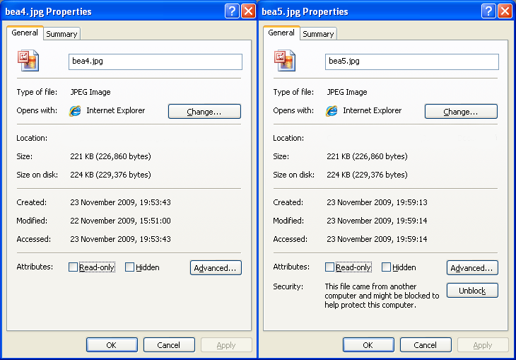

by: najhPosted on 2009-11-23 at 12:25:51ID: 25891223
The story has now become a bit more convoluted.  I just tried downloading the images from the website again.  Here's what I did (if anyone's interested)...
First I downloaded one image from the website using IE8 and saved it into the same local directory with a new name.  I then used that image to create another new local web page.  Image didn't show up on IE8.
Then I did the same again using FireFox - I downloaded the same image from the website using firefox and saved it into the same local directory, with another new name.  And then i used that image in a new locally held web page.  And this image IS visible in IE8.
So suddenly I've broken the "curse" on that image which stops it being displayed on this computer... but I don't know how or why!!  So now I have two image files - one which will display in ie8 and one which won't.  When I do an MD5 sum on the two files, they appear to be identical.  When i go into the file properties it seems like windows thinks there's a difference between them though. (see attached propertied)  bea5.jpg loads fine, bea4.jpg doesn't. (but only when held locally of course)
