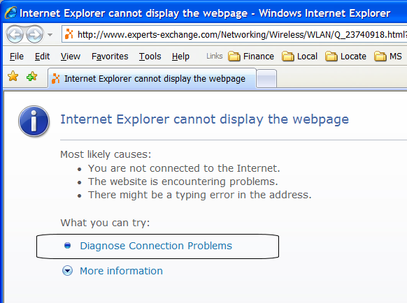

by: Darr247Posted on 2008-09-16 at 15:33:36ID: 22493934
In IE7 if it offers to troubleshoot the problem for you below the 'Page could not be displayed' message, click that link. If there's something wrong with the winsock driver it will prompt you before repairing it, pretty-much obsoleting the various winsockxpfix utils.

by: Darr247Posted on 2008-09-17 at 20:34:59ID: 22507031
Is there a link offering to investigate what's wrong, and did you try it as I suggested?
e.g. See link outlined in attachment.
by: netadminjillPosted on 2008-09-18 at 05:58:06ID: 22510319
The "Diagnose Connection Problems" does not work.  I have turned off "show friendly error messages" and the message is the same... exactly what  Darr247 shows above.
