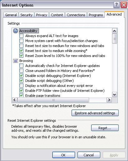

by: virtualxistancePosted on 2009-02-01 at 10:42:37ID: 23522278
Try this, has worked for me in many cases where browser failed to launch.
Right click the IE icon in the Start Menu and go to Internet Explorer Properties,
Under the Advanced Tab, click reset to disable any add on's or other customized settings.
    • 53 KB
    Advanced Tab under IE Properties.
by: Roads_RoadsPosted on 2009-02-01 at 10:47:22ID: 23522298
CardPuller wrote he did it already
