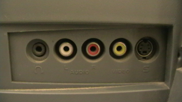

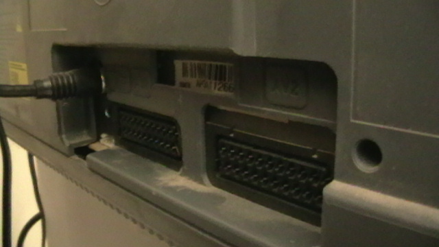

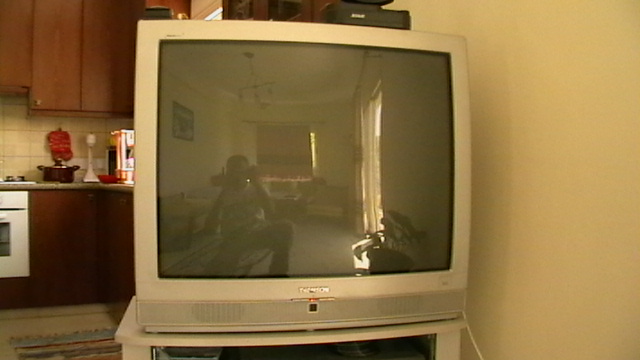

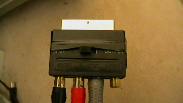

Here are some pics of my tv and connections :). Yes I have an old 33'' Tomson TV which was hard to find and probably last in the market. I don't like wide screens :). There are 2 scart input on the tv where i connected one on pc and the other on dvd player. Second pic shows connections that are on the side of the tv but I am using a scart that connects everything together on the last pic. Yes quality is very
good despite that my cable for connecting the tv and pc is 22m long!
haha yes thats the next step i am thinking to take, as sound is not so loud, and connect tv or pc to my 25 y. old JVC stereo amplifier. Maybe I will need your advice there

What's connected to image IMGA0153.JPG (60 KB)   you can use that to connect your PC to the TV see it has Video / audio is that in or out lol.
But since you have it playing nicely good job.
The scaart cable looks the same as mine.
Use those audio onthe back of the TV if you like to add the the TV audio out to AMP  only if they are out though. Maybe only in since it's an old model.
grab a cable with matching red and white audio left and right and run to the JVC stereo amplifierline in.
