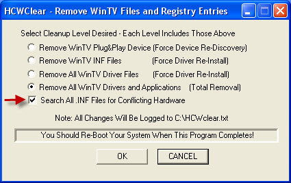

I have figured out how to "show closed captioning" in the WinTV v7 Software. This is what I had to do to make the close captioning work. The version of WinTV Software I orginally had installed didn't support CC. I had to uninstall the WinTV v7 software and download the updated version from Hauppauge's website.
I first had to download and run the Hcwclear uninstall utility.
http://hauppauge.lightpath.net/software/utils/hcwclear.exe
I had to make sure before uninstalling, I had to check SEARCH ALL .INF FILES. In the picture I placed an red arrow to where to check SEARCH ALL .INF FILES.
After the uninstalling is finished, it will ask to reboot. Once the computer is done rebooting, I had to FIRST reinstall the drivers and then the software "WinTV v7".
ftp://www.hauppauge.com/Support/wintv7/wintv7_cd_1.2.exe
