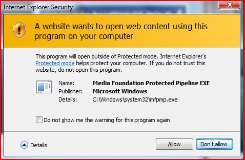

When trying to stream from certain embedded WMV files in Internet Explorer, I get a pop up window, attached below asking for approval to open web content using this program on your computer, and it will open outside of Protected mode.
However, even when i click on allow, it still does not stream the video.
We are using Windows Media Player v11.0.6001.7000 in Windows Vista with all the updates.
If I disable CA Pest Patrol from startup, then i don't get this prompt, n'or does the video open outside of protected mode. everything works perfectly as it should.  However, if i restart PP then i get the same prompt again, and it doesn't matter if i click on allow or don't allow.  I have adjusted and lowered all my security setting to try to bypass this in IE, still to no avail. Additionally, lowing the security settings is not much of an option in my environment.
I have allowed the Media Foundation Protected Pipeline through the firewall both ways, but that still doesn't help it.
When we look at the CA log files, there is no mention of it having a hard time with this exe, n'or is the exe even mentioned. It does not appear to interfere with the file, however when PP is dissabled, it works.
Any help would be great. thanks.

Carlos,
So sorry, i forgot to add the screen shot.
Yes, when running as administrator, it goes no problem. That is with or without CA running. Only when running in protected mode, with CA running do we get the problem.

by: hoc_ITPosted on 2009-02-04 at 06:51:53ID: 23548645
So, here's the thing.  We are fully updated with all the MSO's.
When protected mode is dropped, the media streams perfectly.
All cookies are accepted. - still does not work when in a protected mode.
When added to the trusted sites, the media will stream, but it will open up the full media player and stream there rather than in the webpage.
If I copy the stream location directly into a new page\tab in IE it will pop open the media player and play there.
Even with the firewall dissabled, the problem is the same.
Monitored the differences that are there using procmon when in trusted site and when not, and there is no difference from what Pest Patrol is doing. It's that IE7 is not letting the MFPMP do what it needs to do within IE.  However with Pest Patrol off, there is no prompt, and the media streams as expected.
This I fear is going to be a growing problem as websites are starting to move in to server2008 and will be using the Media Foundations SDK to develop their streaming media. As of lately, we havn't seen a huge problem because most sites havn't gone through the upgrade.
The differences that I can see, is that when a website calls for the MFPMP (it means they used the Media Foudations SDK to prepare their stream) rather than directshow, and there is a component installed that does not allow computer to server direct connects (Media Foundations Protected Pipeline EXE) the stream is killed. However without this, there is no prompt and a direct connect is enabled.
This could also become a security vulnerability as the MFPMP and SDK allows for auto negotiate on the stream, which also means there are several streams in the pipeline, and it waits for your hardware to determine the best stream for your system.  This can open up a lot of "piggybacking" on these streams for virus's or trojans etc.  There should be a popup, but it should be able to work after the popup is allowed.

by: hoc_ITPosted on 2009-02-05 at 04:30:32ID: 23558631
Merete, thank you so much for all your assistance.
I think I have figured out the root cause of the problem, however, I still need a way to fix it.  It appears as though the following process happens when you try to use the media foundation protected pipeline.
1. IE7 calls the file, scans it, reads the hash, and determines that it is the file it wants to use.
2. CA then Virtualizes the file, scans it, says that it is safe (not a virus, etc) tags the header of the file saying that it is safe, releases the file so that IE7 can use it.
3. IE7 gets a new hash (CA changed the hash when it modified the header) and rejects the file.
4. Prompts the user (IE Security dialog box) because it is not the same file that IE7 originally scanned
5. User accepts the use of this file, however, that file was virtualized and no longer exists (it's calling the hash or PID which is different than the original so the process gets hung and never connects.
What I am wondering is, can that process be stopped or modified,  perhaps in the registry etc. If there is a way to tell it to use the exe rather than PID or Hash, or to not scan it and trust it no matter what.
Putting the check box in doesn't work, because the only time you get the IE Security Popup is when it doesn't work. If Protected mode is off, or you paste the link into it's on IE window, the media streams properly.

by: hoc_ITPosted on 2009-02-09 at 05:18:23ID: 23589721
Shutting down CA is not an option.  This is a large corporate environment with rules and standards. DFX is not used in our environment.
However, this being said, i'm glad to report that we have found a potential bug.  mfpmp.exe exists in Windows\system32 folder and (with everything else in there) is pretty much locked down.
IE first looks for this file in Program files\internet explorer.  Funny, it doesn't exists there, but why would IE when calling this file, look there?  I'm not going to go into the details as to how i found that unless and expert really wants to know.
Simply copying the file does not resolve the problem 100%.  The real issue here is that it needs to run with admin rights.  Which it doesn't, this is why when elevating IE it works. So after copying the file, if you go into the compat tab, for all users, and hit the check box saying run as admin, well, voila.  it works.
If possible, lets keep this post open and when Microsoft releases the bug fix, i will post it here.

by: hoc_ITPosted on 2009-09-28 at 06:29:07ID: 31634356
I have resolved the issue.
Also, this is not a Vista bug, this is a Windows "by design"
Experts, should know better to just say "i don't know" rather than sitting on a wild goose chase.
Working between the AV and MS, i resolved the issue, deployed the GPO that will fix the problem, was thanked greatly by both companies.  Found that Win7 will also have the same problem, and it will not be fixed until WIN8 as they will be doing an entirely new OS.
