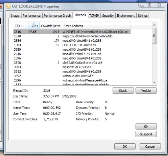

I'm having an issue with Outlook 2007. The CPU ramps up to 50% usage on OUTLOOK.EXE process as soon as a message is received or sent. It will sit dormant until there is an actual message received. If I click the Send/Receive button and no messages come in it does not ramp up.
This is a brand new install of MS Office (trial version but within the 60 days as I'm doing eval. before buying). This seems to be somewhat of a common issue with Outlook 2007 as I do more research. The CPU usage shoots right up to 50% but the memory usage does not appear to increase, so I don't believe there is a memory "leak".

I was also playing around with Process Explorer to try and identify what's going on...but I'm not completely sure what I'm looking at or what to do with the data. The one thing of note is the particular line in the screenshot that appears to take up the resources. This line is not there before the issue begins.
