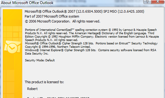

What is the build of the Outlook 2007? Do you have the latest SP i.e. SP 2 applied to Outlook 2007?

I've included the screen print with all the Outlook information. It looks like I have service pack two. What you think?

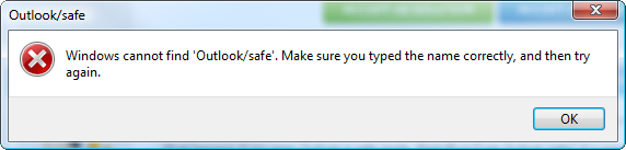

I tried to open Outlook and safe mode and received an error message-see screenshot.

<For the screen shot> Its Outlook /safe there is a space between the Outlook and /safe..
