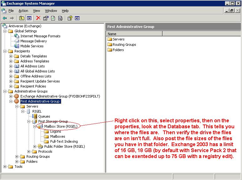

by: leewPosted on 2009-10-10 at 13:18:40ID: 25543628
Please see this picture.

Right click the properties of the First Storage Group (though it should be pretty obvious - if you look in My Computer, which disk is out of space?)

To clean off space on the C: drive, please see:
http://www.lwcomputing.com/tips/static/bootdrivesize.asp
In addition, the Exchange files need to be moved to another drive (see the link above).
