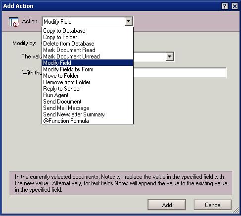

by: mctcallcentrePosted on 2009-08-12 at 22:18:02ID: 25085584
Dear All,
Thank you for your response.
I managed to changed the program fonts but what I'm actually looking for is the way to change the default font when composing new email, for mass users.
I tried to follow suggestion from sjef_bosman, however I'm not quite sure where could I select LotusScript (Please refer to attachment).
Appreciate your advice regarding this.
by: sjef_bosmanPosted on 2009-08-12 at 23:59:37ID: 25085922
You need the Domino Designer client if you want to use LotusScript... Then, when you click New Agent, don't use the Simple Agent type, but the LotusScript type.
by: mctcallcentrePosted on 2009-08-13 at 21:40:49ID: 25095300
Hi sjef_bosman,
So in other word, I won't be able to proceed with this by using a normal Lotus Notes client? Is that right?
by: sjef_bosmanPosted on 2009-08-14 at 02:45:48ID: 25096387
To create a LotusScript agent you NEED (someone with) a Domino Designer client. You can buy a licence and download the software. I don't know if the  software is available as a trial version.
In other words: yes, that's right. Ask your administrator, he might be able to do this for you (assuming he has a Designer client).
by: mctcallcentrePosted on 2009-08-20 at 02:02:29ID: 31611820
I need to use designer, not the one i'm currently using
