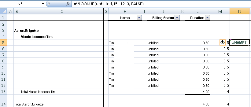

Just wondering why this VLOOKUP doesn't work. Please view image.
Vkimura
=VLOOKUP(unbilled, I5:L12, 3, FALSE)

by: epaclmPosted on 2009-02-25 at 20:30:12ID: 23741573
=VLOOKUP("unbilled" I5:L12, 3, FALSE)
Curt
by: theplonkPosted on 2009-02-25 at 21:37:26ID: 23741849
Your index column "billing status" is on column J. Change I to J. And change unbilled to a string "unbilled".
=VLOOKUP("unbilled", J5:L12, 3, FALSE)
by: epaclmPosted on 2009-02-25 at 21:54:18ID: 23741917
Sorry, I missed the second error :-)
Curt
by: vkimura2007Posted on 2009-02-25 at 22:15:02ID: 23741995
Thanks, Curt.
