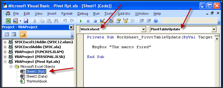

Try putting your expansion code in the PivotTableUpdate Event on the worksheet where your Pivot Table is located.  In the VB Editor, double click the sheet name, In the right hand pane select worksheet from the dropdown and the the event name in the event drop down menu.   The code will run every time the pivot table is updated or a filter is changed, etc...
Private Sub Worksheet_PivotTableUpdate(ByVal Target As PivotTable)
  Your Code here.....
End Sub
by: ProdOpsPosted on 2009-04-23 at 13:23:00ID: 24219407
Graphic attached.... showing the steps described above.
