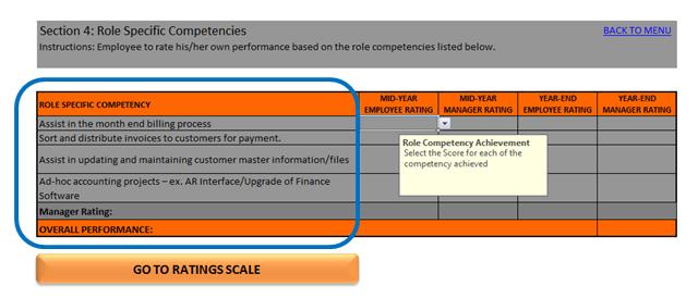

I am trying to run a routine that reads a group of cells on a worksheet. The procedure is being run from within an Access database, but I am working with Excel objects. What I want to do is read the value of a cell, then move focus to the cell directly below that one, and get the value of that. I want to repeat the sequence until the cell being read has a value of "OVERALL PerFORMANCE".
I am trying to move to the next cell using a range.offset(1,0) command. It's not working though. I just keep reading the value of the 1st cell. I've simplified to code to illustrate what is happening.
I need to extract this information from a couple hundred workbooks, so it is important to me that I get this automation working.
What must I do to read the cells working down from the first?
