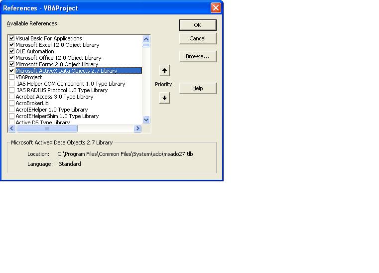

by: sstampfPosted on 2009-10-20 at 02:13:18ID: 25612136
No.........you are mistaken. ADODB does work in Excel 2003. All you need is to create a reference in your project. See the screen shot below. Also please follow the link I have provided and download the excel file I have attached there. See my comments there and try running the code.
    • 45 KB
    These are the references you need to create in order for my code to run

sstampf has the question going on the right track. ADODB does work with Excel and is the prefered, and accepted,  method of bringing data to Excel.
