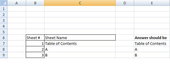

OK. Now we show the label of the worksheet on cells C7:C9 as per question Q_24823541.
So in this question I am looking to find out how to make the answer hyperlinkable, so that the user can be taken to such worksheet, say A1.
The reason I am posting this question is two fold:
1) I do not know how to do it.
2) Please comment on how we are not creating an issue as per the post I found, which of course I do not understand as I do not know VBA.  To summarize it, it mentions
          "Object links cause problems if you have a lot of them.  Changing from object links to
          worksheet hyperlinks opens up its own can of worms, since the worksheet function
           requires the workbook name. "
          http://www.mvps.org/dmcritchie/excel/buildtoc.htm
Thank you,
JP

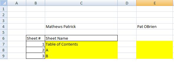

Hi Guys,
I posted a previous question where I received an answer from matthewspatrick and patrickab showing me both how to show the name of the worksheet name that corresponds to the sheet number in column B.
Here I am looking to make that linkable.  So I have attached the answer from the previous question so that you get a better feel of where exactly I need to make such answer linkable.  I created one column for Patrick and one for PatOBrien.
JP

by: matthewspatrickPosted on 2009-10-20 at 04:45:56ID: 25613012
JP,
As I mentioned in my previous comment in this question, you just need to embed the result in a HYPERLINK
formula.  Thus, the formula for C7 would be:
=HYPERLINK("file name.xls#'"&SheetNameFromCodeName("Sheet"&B7)&"'!A1",SheetNameFromCodeName("Sheet"&B7))
Update the file name above, and you will be all set.
Patrick
by: easycapitalPosted on 2009-10-20 at 04:54:34ID: 31642987
Perfect Patrick.
