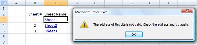

=HYPERLINK("file name.xls#'"&SheetNameFromCodeName("Sheet"&B3)&"'!A1",SheetNameFromCodeName("Sheet"&B3))
Please see attached file and gif shows the error I get.

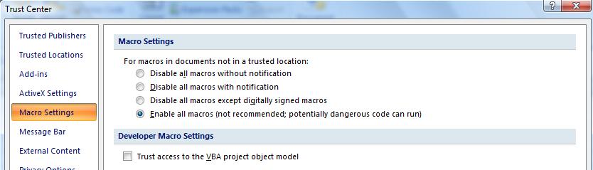

worked for me... do you have macros enabled?

also make sure that file name.xls that you are trying to bring up has the .xls extension not .xlsx (you seem to be using excel 2007 from the screenshot)

The file 'file name.xls' has to be in the same location as the file from which you are linking
by: andreyman3d2kPosted on 2009-10-22 at 08:00:11ID: 25635010
no, the formula does not check for the file name. It has to be named the same as it is in the formula (in this case file name.xls)
It's fine to use excel 2007, just make sure that the extension of the file you are using is .xls
if it is .xlsx you will need to adjust the fformula accordingly

Are you sure that the file you are trying to open is in the same location as the file with the links?
by: easycapitalPosted on 2009-10-22 at 09:03:35ID: 25635763
I am simply trying to open the tabs within the same file.  To connect I just send you a link, and you connect, it is really that simple.

still workin on it... you said that you change the name of the file itself frequently, right?
by: andreyman3d2kPosted on 2009-10-22 at 09:51:48ID: 25636278
okay, try this...
add this function to your vba where the SheetNameFromCodeName function is
Function MyName() As String
    MyName = ThisWorkbook.Name
End Function
Then change the formula to be
=HYPERLINK(MyName()&"#'"&SheetNameFromCodeName("Sheet"&B3)&"'!A1",SheetNameFromCodeName("Sheet"&B3))
(except change the b3 to whatever the appropriate cell is, of course)
attached is the sample file I worked on
by: andreyman3d2kPosted on 2009-10-22 at 09:52:37ID: 25636287
Sorry in my example file, I just fixed the function in cell C4 -- copy it down to the other two cells.

Went to grab dinner.  It works great.  I am indebted.  Thank you very much, JP.
