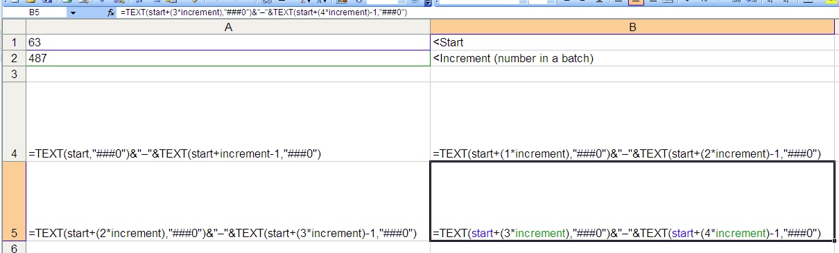

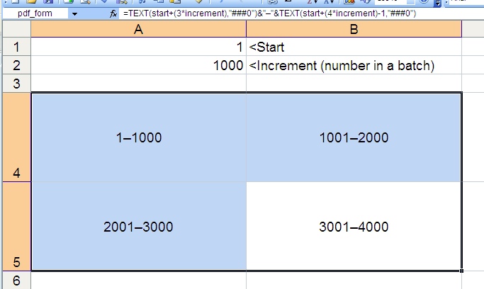

by: EricFletcherPosted on 2009-10-31 at 23:33:23ID: 25712808
The attached shows a way to set it up; I leave the form-fitting to you.
Purists might notice that the formulas insert an "en" dash, Alt-0150, to separate the numeric ranges; a preferred separator to use of a hyphen.
