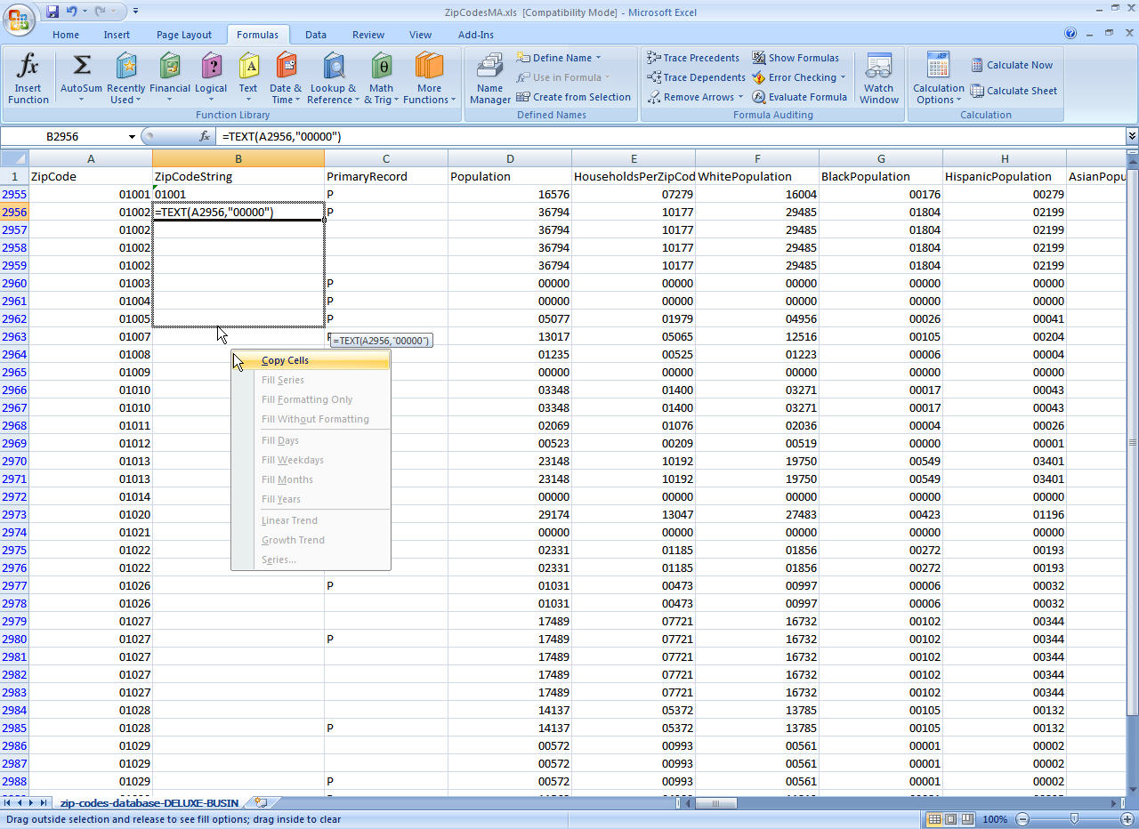

I am having trouble trying to copy a series of formulas.  I created a column in excel and put in this formula in the cell column to the right of it "B2958"
=TEXT(A2958,"00000") all the way down to =TEXT(A6394,"00000") which is the cell where I want to start and end. Placing the formula in the opposing B column B2958 to B6394.
I right clicked on the cell and dragged down the column thinking it would fill a series etc. No luck!
I used to know Excel better I thought............ then Microsoft changed the game a little bit and I can barely find my way around. Any help would be greatly appreciated.

by: ruavol2Posted on 2009-11-03 at 17:20:21ID: 25735616
I tried those things and for some reason it did not work. Here is what I get when I try to copy the formula.
by: roryaPosted on 2009-11-03 at 23:16:24ID: 25737102
When you entered the formula in the first cell, did you see a result, or just the formula itself?
by: ruavol2Posted on 2009-11-04 at 03:26:52ID: 25738219
Just the formula itself. I even hit calculate and nothing happens. I thought this was easier than this.
by: roryaPosted on 2009-11-04 at 03:50:58ID: 25738366
It sounds as if your cells are explicitly formatted as Text then. You will need to format them as General, then re-enter the formula and then copy it down.
HTH
Rory
by: ruavol2Posted on 2009-11-04 at 08:32:32ID: 25741020
Finally. I am not even sure how I did it but that worked.
I changed the entire column back to general.
Then  select the cell in the column you want to copy
place the formula....in my case it was
=TEXT(A2955."00000")
Once the cell had the formula entered into cell B2955
I held down my CTRL button
Left Mouse-click and drag the fill handle at the bottom right corner of the B2955 cell dragged the selected range down to the bottom of the series of rows. I let go and Wallah the result was filled formula results.
Thank you gentlemen. That was much appreciated.
