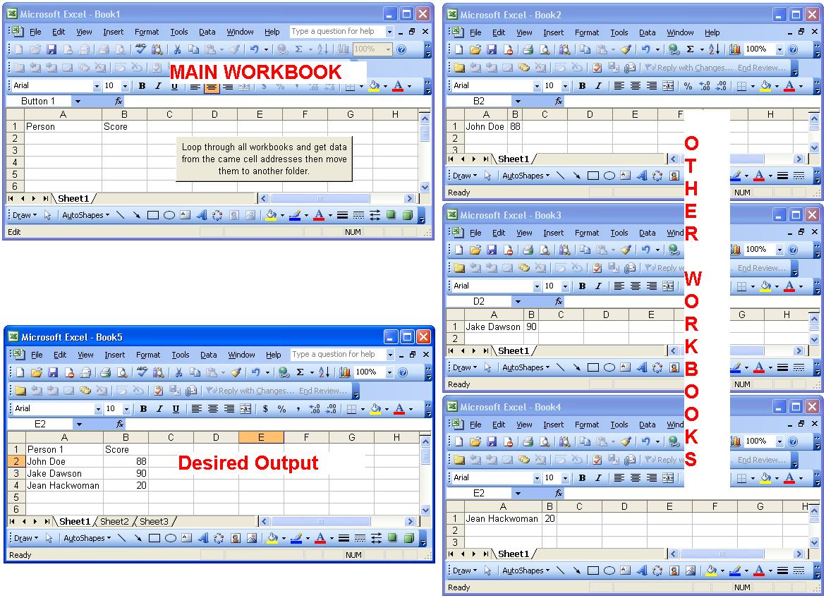

Hi Experts!
I need a VBA code inside a Workbook to search other Excel files in the same directory and get data from them and then save the data in the original workbook.
The data will always be in the same cell addresses in the other workbooks but the filenames may be different. Is this doable with the filenames being different? If not due to limitations, please provide a code if there was a filenaming convention. Also, if data has been taken from the workbooks, they need to be moved to another folder.
I'm sorry if I'm not very clear. I have attached an image to help explain what I need.
Thanks a lot in advance!

by: PatOBrienPosted on 2009-11-03 at 21:16:56ID: 25736608
try this...
may need some tweaking to suit your situation
Sub GatherData()
Dim strPath As String
Dim strFileName As String
Dim wb As Workbook
Dim strSource As String
Dim rngSource As Range
Dim rngTarget As Range
Dim intRowCounter As Integer
Dim strTargetFolder As String
'define where the files are to be copied here (hard coded)
strTargetFolder = "C:\temp"
'or get the foldername from a ws cell  (uncomment the next line)
'strTargetFolder = ActiveSheet.Range("D1") ' or use a named range
strSource = "A1"
strPath = ActiveWorkbook.Path
intRowCounter = 1
'this is where the data will be copied to
Set rngTarget = ActiveSheet.Range("A1")
strFileName = Dir(strPath & "\*.xls")
'make sure that the target folder name has a trailing slash
If Right(strTargetFolder, 1) <> "\" Then
    strTargetFolder = strTargetFolder & "\"
End If
Do While strFileName <> ""
    'skip file if it matches the current workbook name
    If strFileName <> ActiveWorkbook.Name Then
        'open the wb
        Set wb = Workbooks.Open(strPath & "\" & strFileName, False, True)
        'set range of information to be copied
        Set rngSource = wb.Worksheets(1).Range(strSource)
        'copy data from source to target
        rngTarget.Offset(intRowCounter, 0) = rngSource.Value
        rngTarget.Offset(intRowCounter, 1) = rngSource.Offset(0, 1).Value
        'if you want the filename saved in the next column...
        rngTarget.Offset(intRowCounter, 2) = wb.Name
        'increment target row counter
        intRowCounter = intRowCounter + 1
        'close the source workbook with no save
        wb.Close False
        'to do - maybe - test for existence of target folder
        'copy the source wb to the target folder
        FileCopy strPath & "\" & strFileName, strTargetFolder & strFileName
        'to do - maybe - test for existence of file in new target folder then if found, do the delete
        '  note: don't use the DIR command to test for the file.  It resets the dir list.
        'uncomment this line to delete the original - after testing is complete
        'Kill strPath & "\" & strFileName
    End If
    'get next file name
    strFileName = Dir
Loop
MsgBox "Done."
End Sub

by: techfanaticPosted on 2009-11-04 at 02:41:00ID: 25737992
Hi PatOBrien, this is perfect! It works! I have one more question though, which part of the code should I change to add more cell values to be copied to the workbook? For example, I wanted to copy A3, G3, B4 (from source) to columns A, B, C of this workbook?
Thanks!
by: techfanaticPosted on 2009-11-04 at 03:13:05ID: 25738132
Hi PatOBrien, I played around your beautifully commented code and this is what I've changed. So far, it was able to display 4 columns of data correctly. Is this a correct way of modifying your code for multiple cell sources?

by: PatOBrienPosted on 2009-11-04 at 11:53:58ID: 25743201
Yes, that is a perfectly acceptable way to do it.
However, if you're expecting to be constantly adding to the cells that are to be copied, you could reduce the amount of code that you have to change by using an array for the strSource text.
But what you're doing is fine.
