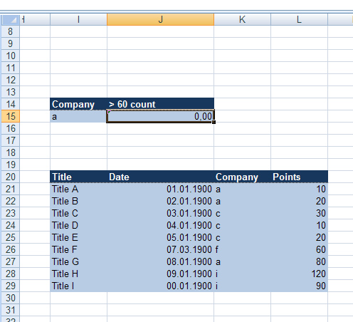

Hi experts, i have a problem, mnaybe the picture will explain it better:
on the selected field i use this formula: =SUMPRODUCT(K21:K29=I15;L21:L29>=60)
the result should be 1 but it#s always show me zero..... or even #VALUE ERROR when i have a lookupcombo behind.
what i need is in the first table the result of how many comapny a have more than 60 points and so one: the right result should looks like:
Company        |     > 60
a                     |          1
c                     |         0
f                      |         1
i                      |          2

by: jppintoPosted on 2009-11-05 at 02:02:28ID: 25747984
Please take a look at the attached file.
jppinto
by: jppintoPosted on 2009-11-05 at 02:04:26ID: 25747990
You formula should be like this:
=SUMPRODUCT((K21:K29=D2)*(L21:L29>=60))
not like this:

Sorry...mistake! Should be like this:
=SUMPRODUCT((K21:K29=I15)*(L21:L29>=60))

You had alot of problems with you sheet. For starting the SUMPRODUCT function must have the same number of rows in each array argument. For instance:
You cannot have this:
=SUMPRODUCT((K21:K29=I15)*(L21:L50>=60))
The ranges must be the same size  K21:K29 and L21:L29 (not L50)!
If you have * in cells where you're performing calculations it will produce an error so you have to check if the value ISERROR() to avoid getting #VALUE on your calculated cells that will give an error where you have SUMPRODUCT formulas.
Hope this helps you to create better sheets now. Please take a look at the link I provided before about the SUMPRODUCT function to see a simple example on how to work with this.

by: patrickabPosted on 2009-11-05 at 04:54:39ID: 25748874
jppinto,
SUMPRODUCT() will work without errors on cells contain the results of calculations containing any mathematical operator (*/+-). However what needs to be checked for is whether a calculation produces an error. Which you've sort of said, but not quite. If there's an error produced by a calculation and that cell in turn is used by a SUMPRODUCT() formula then the SUMPRODUCT() will fail. I think that's what you were getting at. In which case the syntax to trap an error like that would be:
=IF(ISERROR(SUMPRODUCT((K21:K29=I15)*(L21:L29>=60))),"",SUMPRODUCT((K21:K29=I15)*(L21:L29>=60)))
