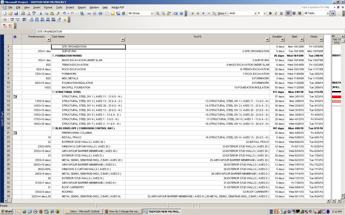

by: broccoliniPosted on 2009-09-02 at 11:10:16ID: 25243842
Almost got it. Seems like just a bit more info is missing. I have attached a print screen, sorry didn't think of that before, was trying to upload the project file. lol. If you see on the last line possible in the print screen, there are 2 predecessors, some of the info is missing on the line.
PB
by: jbfraserPosted on 2009-09-02 at 11:45:09ID: 25244210
The last line, line 35, appears to be correct to me. It shows both predecessors number and their names. What info is missing/ What were you expecting to get?
James Fraser
by: broccoliniPosted on 2009-09-02 at 12:19:44ID: 25244583
There is missing SS+4Days, no way of getting that info in there?
PB
by: jbfraserPosted on 2009-09-02 at 12:45:10ID: 25244836
That's a decent sized additional requirement... I think I've got something for that. Unless I'm missing something, this is not very easy. Give me another hour...
by: jbfraserPosted on 2009-09-02 at 13:47:34ID: 25245552
Here you go. As mentioned, this made the code big, in a hurry. The problem is the large number of ways that lag may be specified.
I've tested this code, but not exhaustively. Please run your own test. By the way, the code can create almost ambiguous displays:
1SS-1 wk-1 Task,2SS-2 day-1 day task

by: jbfraserPosted on 2009-09-02 at 14:45:16ID: 25245970
Argh. There were several bugs in what I posted. Here's a better version.
Sub CreatePredecessorTextName()
    'ATTENTION! The first three constants below may need to be customized for your work calendar!
    Const MinutesPerDay = 480
    Const MinutesPerWeek = 2400
    Const MinutesPerMonth = 9600
    'These should not need customizing
    Const MinutesPerHour = 60
    Const MinutesPerEHour = 60
    Const MinutesPerEDay = 1440
    Const MinutesPerEWeek = 10080
    Const MinutesPerEMonth = 43200  'an emonth is 30 edays.
    Dim t As Task
    ' Use tmpStr to keep the string while it's being built.
    Dim tmpStr As String
    For Each t In ActiveProject.Tasks
        tmpStr = ""
        For Each TaskDep In t.TaskDependencies
           'TaskDep might be a successor or predecessor. We only want predecessors.
           If TaskDep.To.UniqueID = t.UniqueID Then
              tmpStr = tmpStr + "," + CStr(TaskDep.From.ID)
              Select Case TaskDep.Type
                 Case pjFinishToFinish
                    tmpStr = tmpStr + "FF"
                 Case pjStartToStart
                    tmpStr = tmpStr + "SS"
                 Case pjStartToFinish
                    tmpStr = tmpStr + "SF"
                 Case pjFinishToStart
                    If TaskDep.Lag <> 0 Then
                    tmpStr = tmpStr + "FS"
                    End If
              End Select
              ' The minus gets added automatically below.
              If TaskDep.Lag > 0 Then
                 tmpStr = tmpStr + "+"
              End If
                 Select Case TaskDep.LagType
                    Case pjDays
                       If (TaskDep.Lag / MinutesPerDay) <= 1 Then
                          tmpStr = tmpStr + CStr(TaskDep.Lag / MinutesPerDay) + " day"
                       Else
                          tmpStr = tmpStr + CStr(TaskDep.Lag / MinutesPerDay) + " days"
                       End If
                    Case pjDaysEstimated
                          tmpStr = tmpStr + CStr(TaskDep.Lag / MinutesPerDay) + " day?"
                       Else
                          tmpStr = tmpStr + CStr(TaskDep.Lag / MinutesPerDay) + " days?"
                       End If
                    Case pjElapsedDays
                       If (TaskDep.Lag / MinutesPerEDay) <= 1 Then
                          tmpStr = tmpStr + CStr(TaskDep.Lag / MinutesPerEDay) + " eday"
                       Else
                          tmpStr = tmpStr + CStr(TaskDep.Lag / MinutesPerEDay) + " edays"
                       End If
                    Case pjElapsedDaysEstimated
                          tmpStr = tmpStr + CStr(TaskDep.Lag / MinutesPerEDay) + " eday?"
                       Else
                          tmpStr = tmpStr + CStr(TaskDep.Lag / MinutesPerEDay) + " edays?"
                       End If
                    Case pjElapsedHours
                       If (TaskDep.Lag / MinutesPerEHour) <= 1 Then
                          tmpStr = tmpStr + CStr(TaskDep.Lag / MinutesPerEHour) + " ehr"
                       Else
                          tmpStr = tmpStr + CStr(TaskDep.Lag / MinutesPerEHour) + " ehrs"
                       End If
                    Case pjElapsedHoursEstimated
                          tmpStr = tmpStr + CStr(TaskDep.Lag / MinutesPerEHour) + " ehr?"
                       Else
                          tmpStr = tmpStr + CStr(TaskDep.Lag / MinutesPerEHour) + " ehrs?"
                       End If
                    Case pjElapsedMinutes
                       If (TaskDep.Lag) <= 1 Then
                          tmpStr = tmpStr + CStr(TaskDep.Lag) + " emin"
                       Else
                          tmpStr = tmpStr + CStr(TaskDep.Lag) + " emins"
                       End If
                    Case pjElapsedMinutesEstimated
                       Else
                          tmpStr = tmpStr + CStr(TaskDep.Lag) + " emins?"
                       End If
                    Case pjElapsedMonths
                       If (TaskDep.Lag / MinutesPerMonth) <= 1 Then
                          tmpStr = tmpStr + CStr(TaskDep.Lag / MinutesPerMonth) + " emon"
                       Else
                          tmpStr = tmpStr + CStr(TaskDep.Lag / MinutesPerMonth) + " emons"
                       End If
                    Case pjElapsedMonthsEstimated
                       If (TaskDep.Lag / MinutesPerEMonth) <= 1 Then
                          tmpStr = tmpStr + CStr(TaskDep.Lag / MinutesPerEMonth) + " emon?"
                       Else
                          tmpStr = tmpStr + CStr(TaskDep.Lag / MinutesPerEMonth) + " emons?"
                       End If
                    Case pjElapsedWeeks
                       If (TaskDep.Lag / MinutesPerEWeek) <= 1 Then
                          tmpStr = tmpStr + CStr(TaskDep.Lag / MinutesPerEWeek) + " day"
                       Else
                       tmpStr = tmpStr + CStr(TaskDep.Lag / MinutesPerEWeek) + " ewks"
                       End If
                    Case pjElapsedWeeksEstimated
                          tmpStr = tmpStr + CStr(TaskDep.Lag / MinutesPerEWeek) + " ewk?"
                       Else
                       tmpStr = tmpStr + CStr(TaskDep.Lag / MinutesPerEWeek) + " ewks?"
                       End If
                    Case pjHours
                       If (TaskDep.Lag / MinutesPerHour) <= 1 Then
                          tmpStr = tmpStr + CStr(TaskDep.Lag / MinutesPerHour) + " hr"
                       Else
                       tmpStr = tmpStr + CStr(TaskDep.Lag / MinutesPerHour) + " hrs"
                       End If
                    Case pjHoursEstimated
                          tmpStr = tmpStr + CStr(TaskDep.Lag / MinutesPerHour) + " hr?"
                       Else
                       tmpStr = tmpStr + CStr(TaskDep.Lag / MinutesPerHour) + " hrs?"
                       End If
                    Case pjMinutes
                        If TaskDep.Lag <= 1 Then
                          tmpStr = tmpStr + CStr(TaskDep.Lag) + " min"
                       Else
                       tmpStr = tmpStr + CStr(TaskDep.Lag) + " mins"
                       End If
                    Case pjMinutesEstimated
                          tmpStr = tmpStr + CStr(TaskDep.Lag) + " min?"
                       Else
                        tmpStr = tmpStr + CStr(TaskDep.Lag) + " mins?"
                       End If
                    Case pjMonths
                          tmpStr = tmpStr + CStr(TaskDep.Lag / MinutesPerMonth) + " mon"
                       Else
                       tmpStr = tmpStr + CStr(TaskDep.Lag / MinutesPerMonth) + " mons"
                       End If
                    Case pjMonthsEstimated
                          tmpStr = tmpStr + CStr(TaskDep.Lag / MinutesPerMonth) + " mon?"
                       Else
                       tmpStr = tmpStr + CStr(TaskDep.Lag / MinutesPerMonth) + " mons?"
                       End If
                    Case pjWeeks
                       If (TaskDep.Lag / MinutesPerWeek) <= 1 Then
                          tmpStr = tmpStr + CStr(TaskDep.Lag / MinutesPerWeek) + " wk"
                       Else
                       tmpStr = tmpStr + CStr(TaskDep.Lag / MinutesPerWeek) + " wks"
                       End If
                    Case pjWeeksEstimated
                          tmpStr = tmpStr + CStr(TaskDep.Lag / MinutesPerWeek) + " wk?"
                       Else
                          tmpStr = tmpStr + CStr(TaskDep.Lag / MinutesPerWeek) + " wks?"
                       End If
                End Select
                End If
           ' Now the custom bit: Add the previous Task name
           tmpStr = tmpStr + "-" + TaskDep.From.Name
           End If
        Next TaskDep
        ' Now trim off the leading comma.
        If (Len(tmpStr) > 0) Then
           tmpStr = Right(tmpStr, Len(tmpStr) - 1)
        End If
        ' Set the text field.
        t.Text10 = tmpStr
    Next t
MsgBox ("Complete")
End Sub

by: broccoliniPosted on 2009-09-03 at 06:14:54ID: 25250292
Works like a charm and takes into account all the lag times. Thanks for the help James, just wish I could Do things like that myself.
