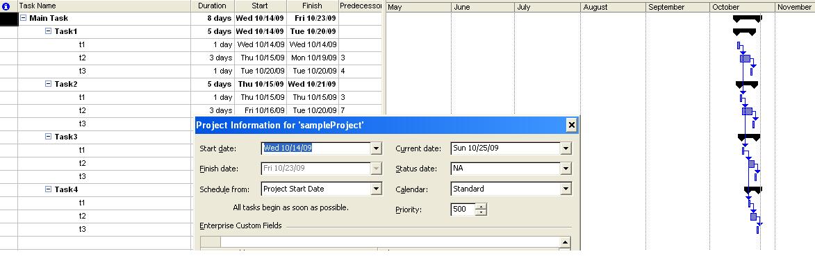

I actuall using MS Project 2003.   I like to start at Oct rather than in june.  I have attach a snapshot of my MS Project

Looking at your snapshot I am a bit confused.
Your project is already starting in October, not June.
Is it perhaps the date format that you are having trouble with?
Your date format is currently MM/DD/YY.

by: tommym121Posted on 2009-10-27 at 17:57:23ID: 25679162
What I meantt is that Gantt Chart should start in Oct rather than June, so I can see more data starting from Oct onward.  By the way I cut off the rest of my project plan and just to show a snap shot and send to you.  Thanks.
by: SnodlanderPosted on 2009-10-28 at 03:30:13ID: 25681567
Your gantt chart DOES start in October!
Are you wanting to see more detail on the right hand side of the page where the bars are? i.e. broken down into Days as opposed to Months perhaps?
If so, right-click on "October" (or anywhere else for that matter) on the date bar at the top of the right-hand side of the chart (i.e. above the blue bars). Select "Zoom" and then choose the option "Entire Project"

by: tommym121Posted on 2009-10-29 at 19:51:56ID: 25699911
I try to make the bars (start in October) close to the Predecessor column, i.e., without seeing any months that is more than October.
by: SnodlanderPosted on 2009-10-30 at 01:33:04ID: 25700963
Sure, no problem.
Above the side of the chart with the bars is a "Timescale" bar that currently shows "July August September October November etc."
Right-click anywhere on this timescale bar.
Select "Zoom"
and then choose "Entire Project"
That will fix it for you.
