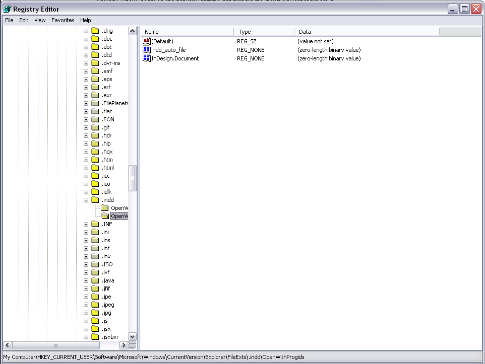

by: pukunuiPosted on 2008-04-02 at 13:48:50ID: 21267359
Flubbster: I followed your directions. Please see the attached jpeg for the result.

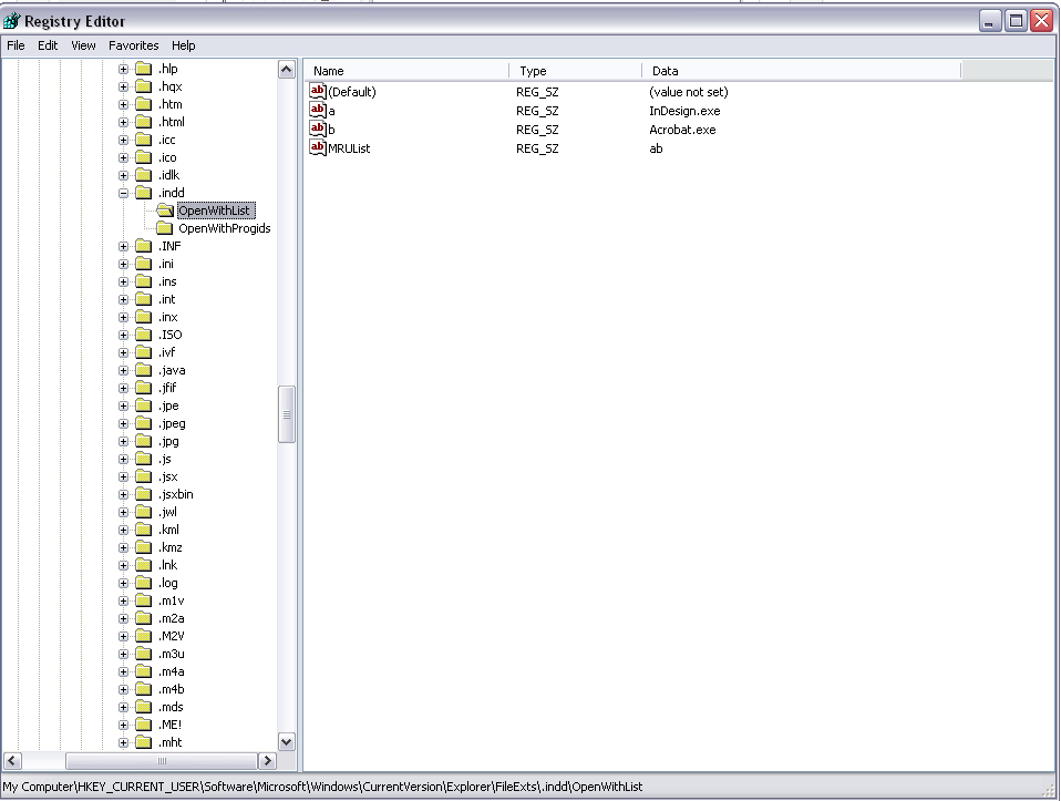

by: flubbsterPosted on 2008-04-02 at 14:08:17ID: 21267556
Could you also post the entries, if any, for the OpenWithList?
by: pukunuiPosted on 2008-04-02 at 14:16:08ID: 21267629
Here you go
by: flubbsterPosted on 2008-04-02 at 14:29:37ID: 21267744
OK... OpenWithList shows InDesign as the first selection to open .indd files. I do not have this program, so I am assuming that is the correct entry.
Having said that, I believe the problem may be the entry in the OpenWithProgids entry. The one that says:
indd_auto_file
Record or export that key so you can change it back if required.
Double click the key and change it to:  InDesign.indd.versionmajor.version.minor
where: versionmajor.versionminor is the version of the program. ie. 3.2  It is not really needed and can be excluded. It is needed mainly if 2 or more different versions of the same program are on the system.
After making the change, exit out and do the following:
Right-click a .indd file and select InDesign to open it. After it opens, close the program. Then, try to just double-click the file and see if it works.

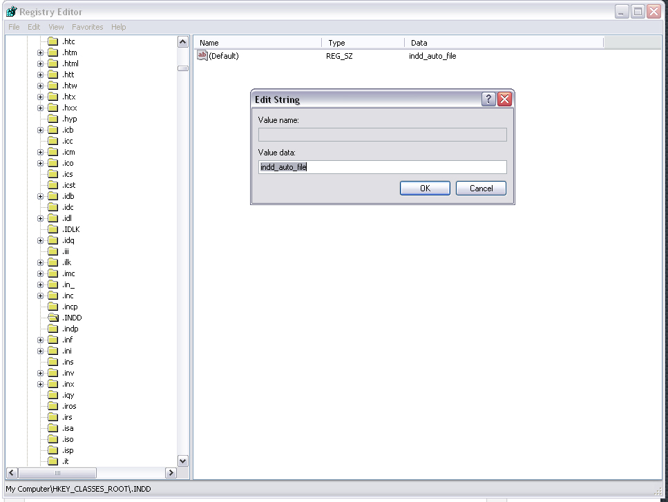

by: pukunuiPosted on 2008-04-02 at 16:37:34ID: 21268547
LOL.
OK, for starters I've got INDD in all caps. Dunno if that matters or not. There's just one key in the file. It's just a default string value which appears to be connected to that indd_auto_file that I deleted.
Could we be getting somewhere finally?

by: pukunuiPosted on 2008-04-02 at 17:09:39ID: 21268711
Here
by: flubbsterPosted on 2008-04-02 at 18:05:51ID: 21269018
This is tough. It looks like it is miising the associated shell commands. If you look at another entry in the same subkeys..for example, look at the .doc extension under Hkey_root, you should see an openswithlist, shell, etc. That needs to be created for .indd.
Try using right-click on a file and select browse. Select the program and make sure "always use this program" is checked. Also, open a folder, click Tools-options-File Types, and see what is listed under indd.

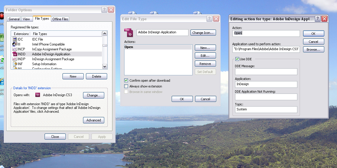

by: pukunuiPosted on 2008-04-03 at 13:31:12ID: 21276664
I haven't done the uninstall/reinstall. I want to avoid that if I can as I need to use InDesign right now and my laptop is on the fritz, so I can't really afford to do a clean install right now (it took forever the first time). If we exhaust all other possibilities, then I'll try the clean install on the weekend.
OK, now I think we may have found the root of the problem. When I go to the .indd file in File Types, I don't get the "advanced" button. Instead, I get a "restore" button. If I click on it, it makes it so that no program opens the file. The InDesign icon remains though, interestingly enough. If I then go get it to open with InDesign, the "advanced" button changes back to the "restore" button again.
by: pukunuiPosted on 2008-04-03 at 13:42:06ID: 21276761
I just tried hitting "restore" again then went into "advanced" and created a new action called "Open" with InDesign.exe as the program. That put InDesign back in the Open With box. However, it still only opens InDesign but not the actual file.
I didn't select "use DDE" when I created the action, but when I went back and checked, it had checked itself. Here's what I can see right now ...
by: flubbsterPosted on 2008-04-03 at 14:46:36ID: 21277271
Back... lol  I was on a phone interview
Ok... in the 'Application used to perform action' box, scroll to the very end of the line. I see that there are quotes around the whole thing, which is good.
If not there, at the very end, put a space, then "%1"
so it looks like this: "D:\Whateverprogram.exe" "%1"
apply and try it. If no go, try deselecting use DDE
by: pukunuiPosted on 2008-04-03 at 15:00:19ID: 21277363
Oh yeah! It's working!!
The %1 was there but it wasn't in quotes, so I put them in and BINGO!!
