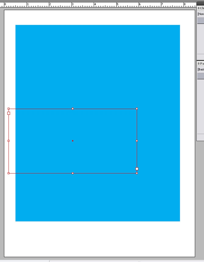

Here are pictures to illustrate what I was saying.
Image 01: I put a blue rectangle on my page so my white text box would show up. As you can see, I drew my text box on top of the blue rectangle, but it has no fill yet.

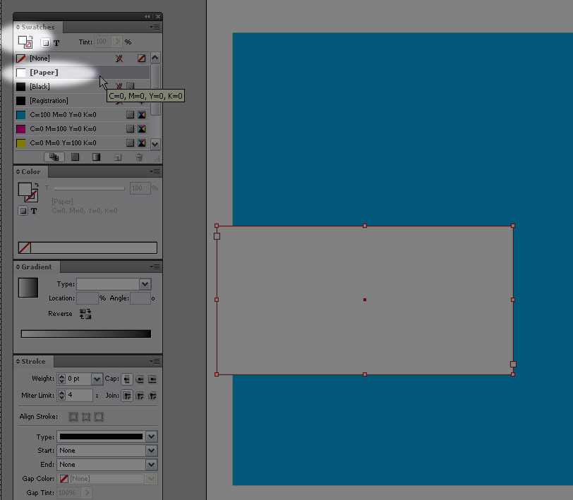

Image 02: My text box is still selected. In my Swatches panel, I click the "fill" icon at the top, then I click my [paper] swatch. This puts a white fill on the text box.

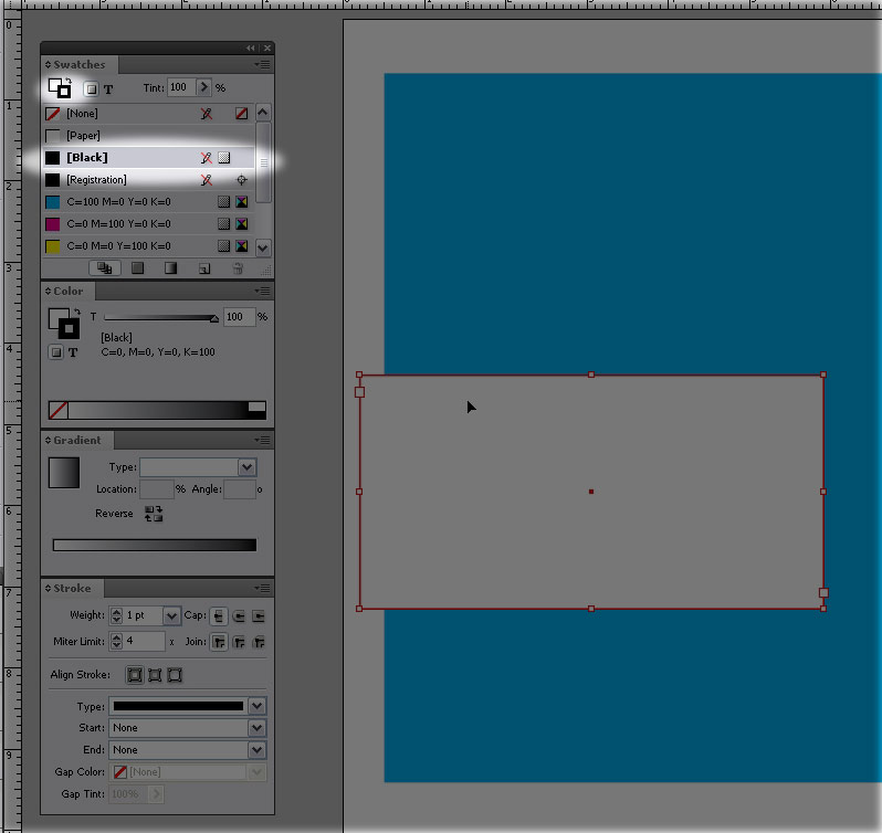

Image 03: With my text box still selected, I click the "stroke" icon in the Swatches panel, then I pick a swatch color for the stroke.

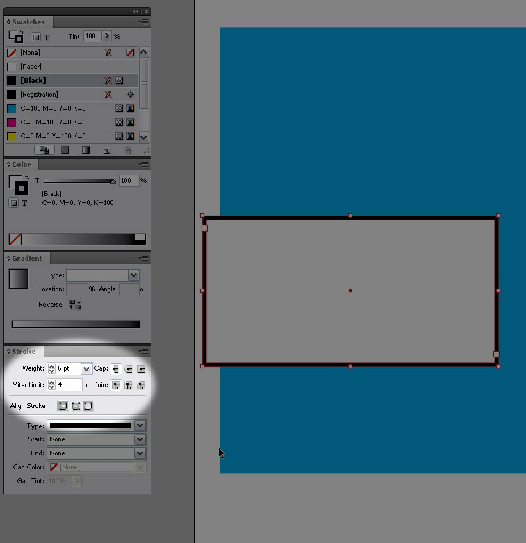

Image 04: The default stroke width is 1point, so to change that I go to my Stroke panel and increase or decrease it.
